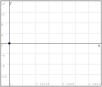

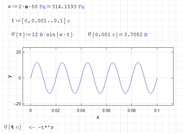

I am a satisfied SMath user and have recommended it to my engineering students. We have immediately stumbled over a huge problem. We are unable to show any meaningful graphs of real problems. With units, correct names or descriptions on axes, etc. I have tried everything, but once I don't see any errors, the graph still shows nothing. Then, there is an error, something like "Result is over max. positive number." I am just trying to display a sine wave voltage. Please, can somebody help me? I was googling extensively, but when there is a promising answer, it is very vague, just showing that it is possible without any help.
This is just my trials, but I have not been able to get any curves in the several graphs.
Edit: The image does not show. You can find it here: http://public.uli.cz/smath-plot.png
Thanks a lot
Olda

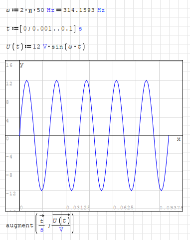

If you are working with vectors, you need to use vectorize().
If you are trying to plot, only Y axis values not enough.
You have to tell what are X values also.
#3 Posted: 2026/3/16 13:39:19
598 likes in 1,380 posts.
You can animate it too.
sinewave.sm (6.69 KiB) downloaded 408 time(s).

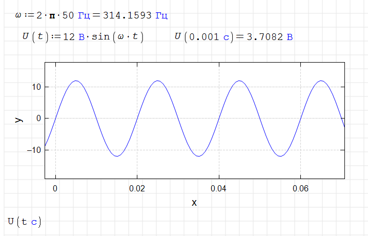

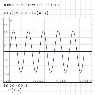

Historically, many components in a document have only one placeholder. This applies to plot components as well. Therefore, working with them is different. With only one placeholder, it's difficult to explain to the component what's expected of it.
This was originally done to simplify component creation. It was later retained for compatibility reasons.
Now, by default, the argument range is taken from the plot itself; it doesn't need to be specified explicitly.
In the plot above, we say to use the x-axis value with a specific unit as an argument so that the calculation inside the component does not return an error.
Using a vector (range variable) is a special case for X-Y Plot.

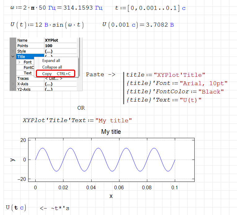

Now, is there a reasonably simple way to get t [s] and U [V] to the axes? Or at least some description.
Mathcad will never be able to do this. This is one of the options.
Actually there is a simple way.
But you have to know something beforehand.
Because you are so used to it, you think mathcad-way.
You need to start thinking smath-way.

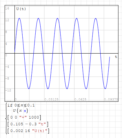

Thanks very much to all of you. I think now I see that working with units is no problem. My question was more cosmetical, presentational. Can the x and y at the axes be replaced? You know, those are the questions of my students.

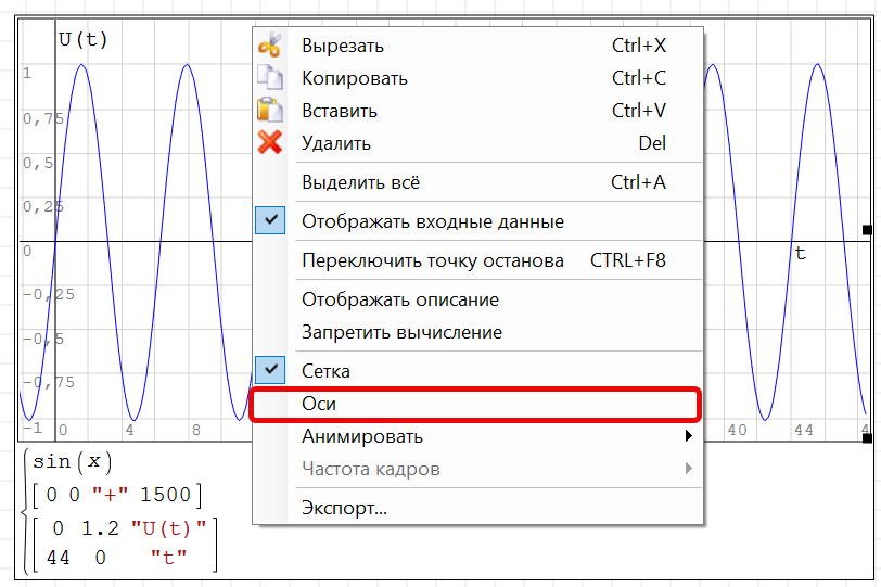

I don't know how to do this for a regular 2D Plot. You could try disabling the axes and drawing what you need yourself.
#10 Posted: 2026/3/19 13:12:32

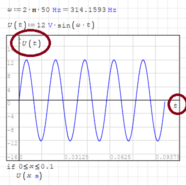

Not easily, but original axes can be disabled via right-click.
And new origin rays and labels can be inserted.
However, this is not a perfect replacement.
You will need to manipulate each different plot.

Ok. One more silly question. How do I get the long curly brace under the plot to put the definitions there? I am clicking right-left, double-clicking... nothing.
Thank you
Edited 2026/3/20 12:40:35
#12 Posted: 2026/3/20 13:06:48
It is the sys() function. Matrices and system of values similar but not same.
