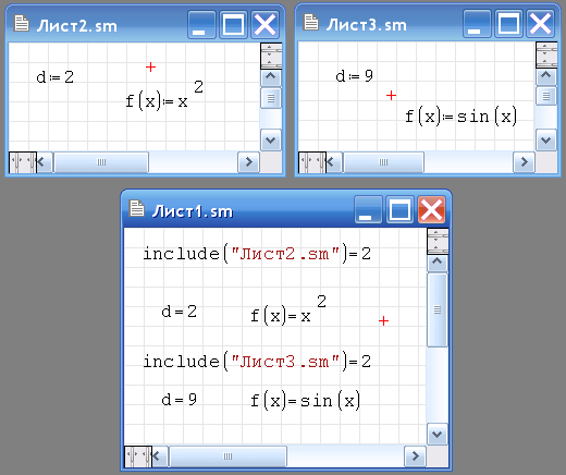

As explained by Viacheslav here include doesn't load the regions (any region), it loads only the xml code of the math regions. Hence, the ComboBoxList in "Loads - Gravity.sm" acts like it is disabled -> the output value K.LL is an unknown -> q.LLResult is not defined because not all the arguments are defined.
As stated before (I can't find the thread) probably it is possible to provide a fix working on both sides (include plugin and any region plugin that feed the canvas with values, adding a hook in the xml), however the behavior would be static (what is saved is what you have).

Current version of the function is unlikely to be improved. I created it as a crutch until you see the full version which only Andrey can give. I understand your wishes as to what it should do. I assure you, if I knew how to do it, I would do it. As for the ComboBox, and other components, yes, they are ignored. This function works as a text file parser. It works only with the data that can be recovered "manually" from the file. In fact, to load an external file it is necessary to use a set of built-in functions. But they are not available for the simple function from a plugin. That's why I wrote that it is impossible to calculate the state of the ComboBox and other visual components (for now). Yes, I can parse data from file but I can't recover the state of object in a proper way. Therefore, in its current form it is a dead end road. My advice is to use the function only for simple applications (a set of constants, functions, etc).

It is necessary to avoid recursion. I still can't catch this type of error in all cases. The only thing to keep in mind - it is the replacement of definitions. But I think this is normal behavior. Or you can suggest the rules how to resolve such kind of collision.

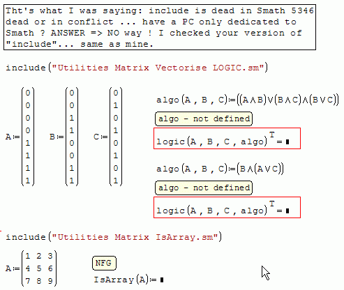

include("string") - include sm-file.
I haven't seen an example of that, working.

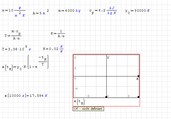

2D Plot does not work with units
I tried to plot a function according the instruction of Sebastian Schluricke shown at www.youtube.com/watch?v=AtICkHXHFpk
His example I could easily do. But as soon if I go over to my calculations where I work with units I cannot plot them. I receive only the message variable not defined.
What is wrong here?

I most appreciate your convincing demo.
Happy users if "include" 5346 works for you.
Dead for me, I don't care much.
