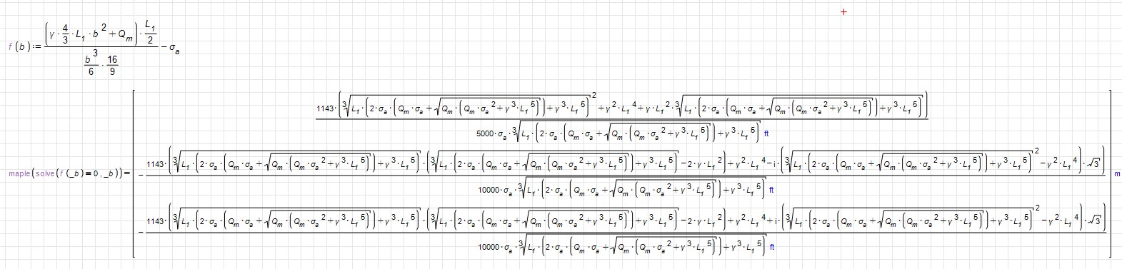

[Using Maple]: Since you already constructed f( b ), all you need to do is perform a symbolic evaluation (keypress [Ctrl] + [.] instead of [=]). This will produce the following:
NOTE: you cannot have any of the variables defined, else those values will be treated as constants and thus substituted into the equation.
You can copy the text below and paste it into your worksheet; this will generate the result based off of your variables (I work in imperial, thus 'ft' is referenced):
{1143*((nthroot(L.1*(2*σ.a*(Q.m*σ.a+sqrt(Q.m*(Q.m*σ.a^2+γ^3*L.1^5)))+γ^3*L.1^5),3))^2+γ^2*L.1^4+γ*L.1^2*nthroot(L.1*(2*σ.a*(Q.m*σ.a+sqrt(Q.m*(Q.m*σ.a^2+γ^3*L.1^5)))+γ^3*L.1^5),3))}/{5000*σ.a*nthroot(L.1*(2*σ.a*(Q.m*σ.a+sqrt(Q.m*(Q.m*σ.a^2+γ^3*L.1^5)))+γ^3*L.1^5),3)*'ft}

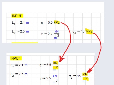

This brings us to units; by solving symbolically, you can identify those variables where the units "don't match". It looks like pressure is your culprit...
I haven't had much success using pressure with regards to force; there is something with regards to the gravitational constant that doesn't quite work right. Therefore, I consider pressure to be of units force/area instead of mass/area. This will cause the units of your inputs to change as such:

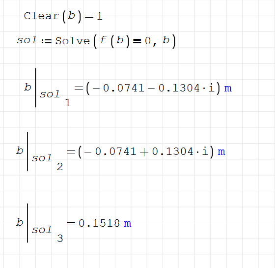

Q2: What is a best way to solve this as a system of equations (instead of substitution in order to arrive to a single eqn presented)?
While solve() and roots() can't work with units, you can "trick" them by altering your equation.
And there are many possible ways to solve with units, please check the examples below.
5-6-14.sm (127.82 KiB) downloaded 1115 time(s).
