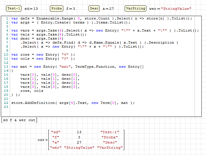

Вот так можно решить задачу при помощи компонента Скрипт.
![2017-03-05 20-38-03 SMath Studio - [Script. Kross example 1.sm ].png](/zh-Hans-CN/files/Download/PV2XNT/2017-03-05-20-38-03-SMath-Studio---[Script.-Kross-example-1.sm-].png)
Script. Kross example 1.sm (6.33 KiB) downloaded 673 time(s).
Script. Kross example 1.pdf (18.03 KiB) downloaded 377 time(s).
var defs = Enumerable.Range( 0, store.Count ).Select( n => store[n] ).ToList();
var args = ( Entry.Create( terms ) ).Items.ToList();
var vars = args.Take(4).Select( x => new Entry( "\"" + x.Text + "\"" ) ).ToList();
var vals = args.Take(4).ToList();
var desc = args.Take(4)
.Select( x => defs.Find( d => d.Name.Equals( x.Text ) ).Description )
.Select( x => new Entry( "\"" + x + "\"" ) ).ToList();
var rows = new Entry( "4" );
var cols = new Entry( "3" );
var mat = new Entry( "mat", TermType.Function, new Entry[]
vars[0], vals[0], desc[0],
vars[1], vals[1], desc[1],
vars[2], vals[2], desc[2],
vars[3], vals[3], desc[3],
rows, cols
store.AddDefinition( args[4].Text, new Term[0], mat );

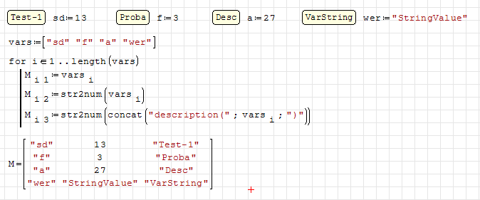

Is there access to some list of definitions in the sheet? The script example seems to reqire explicit specification, which variables are to be processed. Could I just ask to export everything (excluding pre-defined names)?
If specification of the variables is acceptable, then the matrix can be created relying on math regions only.
export.sm (6.2 KiB) downloaded 665 time(s).
![2017-03-05 18_00_56-SMath Studio 0.98.6179 - [Script.%20Kross%20example%201.sm_].png](/zh-Hans-CN/files/Download/GQZK4L/2017-03-05-18_00_56-SMath-Studio-0.98.6179---[Script.%20Kross%20example%201.sm_].png)

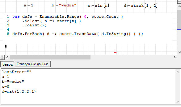

How to check this.
.ToList();
defs.ForEach( d => store.TraceData( d.ToString() ) );
![2017-03-05 22-21-48 SMath Studio - [List1 ].png](/zh-Hans-CN/files/Download/3TLzsX/2017-03-05-22-21-48-SMath-Studio---[List1-].png)

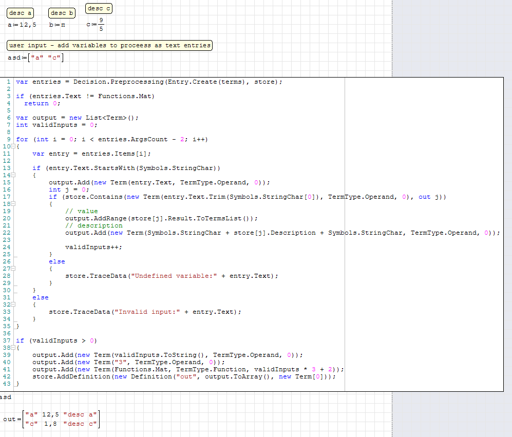

Something close to your request (input must be provided with strings, output is automated and issues reported in trace window)
name+value+description.sm (7.5 KiB) downloaded 675 time(s).
![2017-03-17 16_41_00-SMath Studio - [name+value+description.sm_].png](/zh-Hans-CN/files/Download/CYXgmr/2017-03-17-16_41_00-SMath-Studio---[name+value+description.sm_].png)
