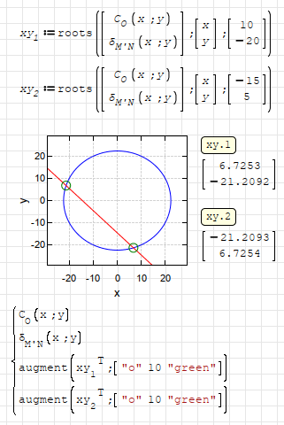

roots(3) solves intersection(s) of two symbolic differentiable functions.
Initialize wisely the third argument of roots(3)

Good! You tell me that there are two solutions.
This is why we have roots(3).
Solving without plotting is bad exercise.
You may have full, correct and single answers without guesses for some equations.
But sometimes you are gonna need to plot equations, find intersections and their coordinates.
If you determine good guess points, it will show you nearest results to that coordinates.

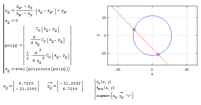

#9 Posted: 2023/7/20 16:42:03
1,078 likes in 1,749 posts.
Hi Nicolas.
Good! You tell me that there are two solutions. I agree! But in this case the roots(2) function should mention them as such.
Not in this case, because SMath's solve is a numerical procedure. You can demand that of maple's solve() or Maxima's Solve() .
In addition, the other intersection has coordinates x=-6.72537 and y=+21.20924.
Not that fast ... the values for x are +6.7253 and -21.2093.
My request is that you show me another method of calculation, which will offer me a solution automatically applicable to the case in question. Automatically, meaning without my intervention from the console.
Although I think that overlord's solution shows the correct solution, this other method does not require initial values, since it makes use of the knowledge that the solution implies a quadratic equation, assuming that the line M'N is not vertical .
Sophism.sm (35.61 KiB) downloaded 919 time(s).

#11 Posted: 2023/7/21 08:31:00
Nicolae Olaru
Nicolae Olaru
1 likes in 115 posts.
With a suitable pair of guess values, the problem will always indicate the pair of variables of the considered point, as can be seen in the attachment. Thanks for the guidance.Image_.png
