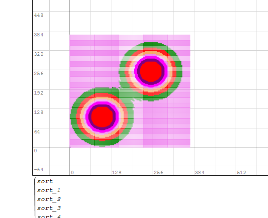

Hello all. This is my case. It runs dramatically low. Can anyone give a hint for increasing speed? Or such a situation is normlal. Thanks.Postroenie polja riska.sm (148.07 KiB) downloaded 1009 time(s).
#2 Posted: 2020/2/1 14:27:20
Select all regions and put Optimization->Numeric

Great! Fantastic! I was nearly diappointed, but it is really TOOL.

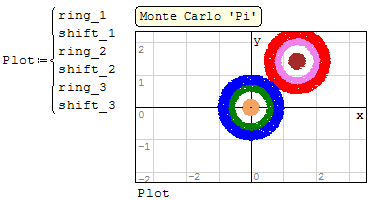

Much different stuff ... you can shift another set,
as well as plot in a random filled square.
Too long to resume in my laptop.
Circle Magic Disk.sm (27.28 KiB) downloaded 1050 time(s).

As interpreted ... ?
1. You can have as many rings as desired, sizes as well.
2. It may be profitable to transit/spool to file.
3. You may have in any Web colors from otherwise construction ?
4. Rectangle may be added ?
Circle Monte Carlo.sm (24.04 KiB) downloaded 980 time(s).
