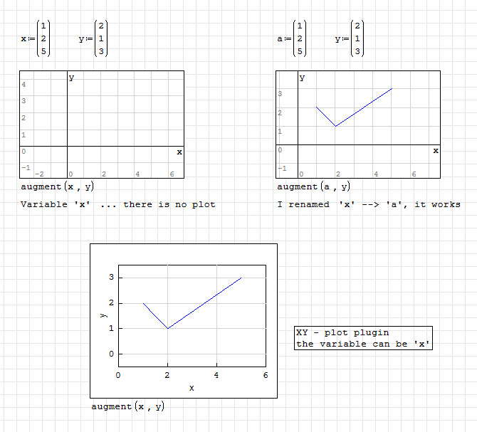

Hello.
It is not possible to plot an augment function with 'x' as parametr.
Is it a bug, or some special feature of 'x'?
regards Olik
#2 Posted: 2015/11/26 20:40:18
1,443 likes in 2,935 posts.
This is not a bug. In the 2D plot region x and t are special unknowns (abscissa and animation parameter); both are parsed as local variables (doesn't matter if there are these variables on the canvas as defined values - except for t that can be used if you don't animate the plot). Therefore when you write augment(x,y) you are trying to augment each x displayed in the plot with y.
Obviously you can define the input matrix before the plot, outside the region placeholder; in this case x and y are parsed outside the plot and the input is simply the 3x2 matrix.
The X-Y plot works differently.
