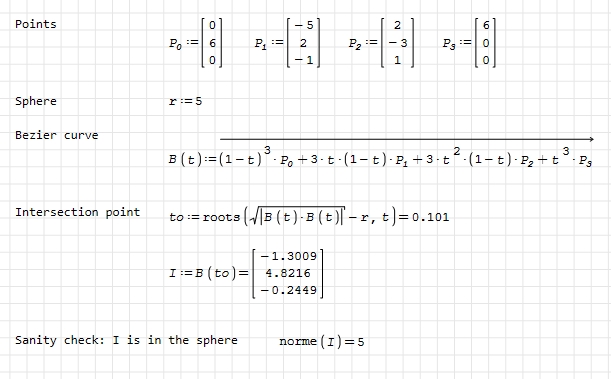

#9 Posted: 2021/9/15 20:57:18
1,123 likes in 1,795 posts.
Hi. In the attached how to solve the problem numerically. Notice that B(t) must to be defined using vectorize, because SMath don't expand the scalar by vector products.
Sphere and Cubic.sm (8.86 KiB) downloaded 1035 time(s).

Hi. Notice that P0, ..., P3 are vectors with 3 components, not scalars. You can't get the distance with B(t).B(t) using P's as scalars.
