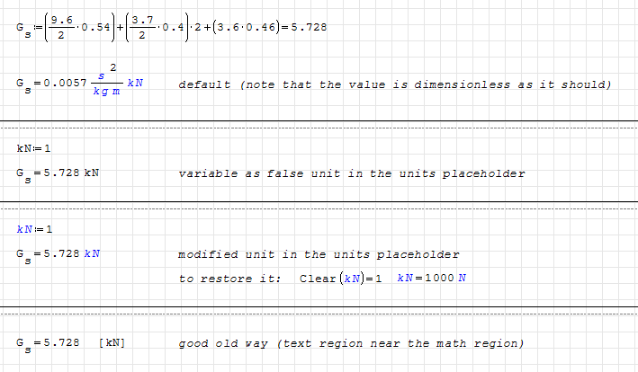

Hello Stuart,
First of all, seems you are running an outdated (and buggy) version of SS (0.98.6179 probably); my suggestion is to switch ASAP to the latest stable version.
SMath provides a dimension consistency check when you type a custom unit in the units' placeholder, therefore when you try to modify the unit of a dimensionless number to something, the inverse multiplies your unit to have the right dimension; in your SS it is obviously buggy because Pascal isn't the inverse dimension of kN (pressure vs force). With latest stable or nighty build you should see:

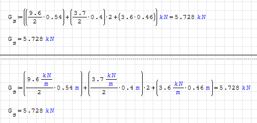

If your intent is just to display an unit for dimensionles values, thee are several other ways:
Or even you can use the units in the definition of G.s ("globally" for the whole variable or "locally" for each term inside it).
frapuano 2017/11/29 04:39:00, studoc 2017/11/29 21:08:00
