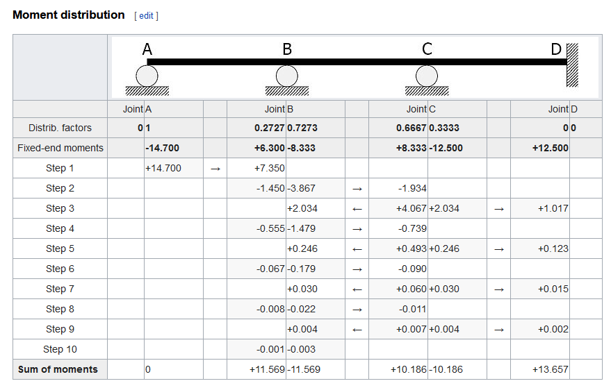

Its the part below that is the technically new/challenging part for me. I cant quite visualize the "framework" to set it up if you will.
steps are the missing links ... out of the blue !
