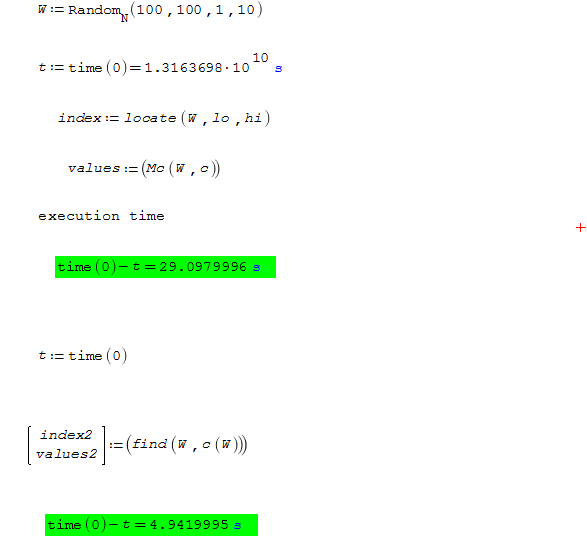

Hi Jean,
Great stuff. I think I've optimized the algorithm for larger matrices by modifying my find algorithm from interX.
For a 100x100 matrix the execution time is improved by nearly 6x.
Utilities Matrix Truth Table [Locate row_col]_alyles.sm (23.14 KiB) downloaded 979 time(s).
