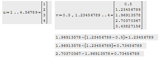

I am currently following along with the SMath Primer and have run into an issue with vector operations on page 26 of the pdf.I am using the range 2 & 3 functions but SMath tells me they are undefined. Is this a known bug or what am I doing wrong? I am currently using Version .99 Build 7030

There are many more ways to range/discretize.
Can't reproduce. Please attach the .sm file.
#5 Posted: 2020/4/4 08:02:01
I Can reproduce SS 6179, but [range] in 1*1 matrix is wrongdoing.
Collab may have used 'u' previously ... thus Clear(u)=

Is there an issue with having two instances of SMath open at once? I closed the software and reopened it at home and it worked fine. Thanks for the help!

Is there an issue with having two instances of SMath open at once ?
NO such issue was reported ... proof:
Open Smath from fresh Win 10 ... work my stuff.
Download work sheet from the Forum ... as many as you want.
Those download are new instances, all working independently.
#8 Posted: 2020/4/6 11:06:24
There is/are no technical justification to open several Smath instances.
It computes the displayed document ... same as Mathcad.
In other words: multiple instances don't multiple compute.
