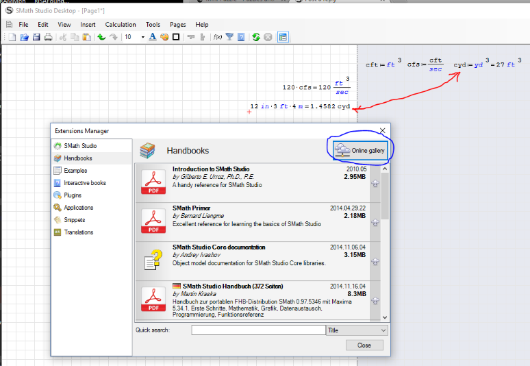

Hi Forum,
I am new to SMath, and am wondering how additional units can be added to the built-in list. Like cu ft, or cu yds for volume, US tons, cubic feet per second, etc. Have others added to the built-in units, or is there a quick way to import a library with a broader range of units?
Thank you!

The most complete unit conversion system I know of:
"Katmar" Uconeer 2.4 [freeware].
From there on, built your own missing in Smath.

Hello, take a look here. Use it as reference, I guess the built-in units file was updated since the last update of the file linked by Martin Kraska.
