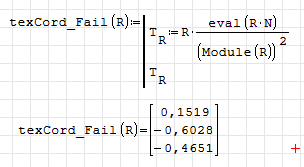

Here is in attachment files illustrating wrong computation of local variable.
Using version 0.98 (build: 5935)
bug.sm (7.04 KiB) downloaded 750 time(s).
Seems that it incorrectly optimizes the order of evaluation (despite brackets explicitly set).
This looks like a bug.
Aside, please note that this may be simplified like at the top of the screenshot.
Submitted SS-2340

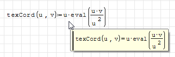

A workaround:
And BTW, you may rewrite your Module() like this:
because scalar multiplication of vectors is sum of products of their corresponding elements multiplied by cos of angle between them - and for identical vectors, cosine is 1.

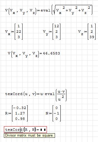

Jean,
Any idea why does not evaluate but gives error message?
Basile
Basile
