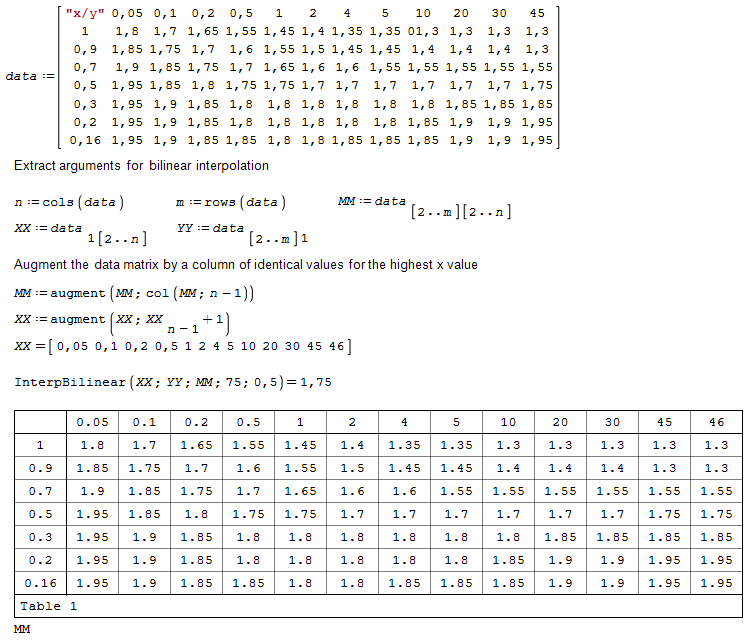

Awesome. When x=70, y=0.5, I need it to be 1.75 per code because x>45 but the function gives me 1.83. How would I modify the code for Spline to achieve this.
#9 Posted: 2021/4/22 15:37:25
1,308 likes in 2,221 posts.

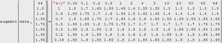

Obviously the function uses linear extrapolation beyond the limits of the data array.
Without touching the function you can enforce constant extrapolation by repeating the first or last rows or columns of data.
surface.sm (18.8 KiB) downloaded 597 time(s).

#10 Posted: 2021/4/22 16:46:35
... as simple as that, preserving last two cols linearity.
