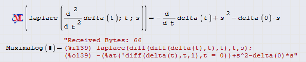

Whatever I do on Maxima side, if the result contains a symbolic non-simplificable substitution (can happen with laplace transforms) then I'd like to display that using the at() function with it's nice operator form to display the result. Yet, as of now, the function isn't robust enough for this.
In the example below you see that the return value from Maxima contains an expression with at(), which is removed on SMath postprocessing side even if optimization=none.
It is part of the test suite for Maxima in the interactive handbook or on github.

The limit function, by the way is another construction site. Currently, it is not possible to use the single-sided limits. We have that on our todo list.

Alvaro 2023/7/26 22:13:00
Hi Martin,
I think I can handle it plugin-side, I'll look into it ASAP.
