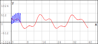

Attempting to transfer a worksheet from MC Prime to SMATH. Couldn't get page 3 of my SMATH sheet to augment the x & y data for the graph; I tried a few variations , yet unsuccessful. I welcome any input(s)/recommendation(s).

Hi Nasch. This is an option.

Here's the updated worksheet.
Review of System Transients.sm (197.75 KiB) downloaded 724 time(s).
The graphs differ some from the MC version, also some added data/lines in the graphs are exhibited.

Ah-h! I tweaked the 1st line under the "for" loop and the graphs are better.

WroteThe graphs differ some from the MC version, also some added data/lines in the graphs are exhibited.
Something like this ?
Review of System Transients (2).sm (280.61 KiB) downloaded 733 time(s).
Hi Norm. This version returns the same plots. Initials conditions in yellow.
