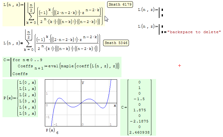

#4 Posted: 2017/8/9 11:18:06
"Variable and Function Names Can't Start With Number"
That what it means. Since 6179, Sum needs be locally defined.

#8 Posted: 2017/8/10 12:28:49
"Variable and function names can't start with number"
[Old work sheet that now produces error]
That's what you have to isolate first, it was created 5346 or earlier version.
If so => the suspect is the Sum(s). Personally, I have dozens of those.
Good thing we know how to doctor.

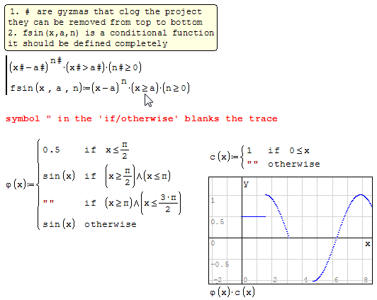

#10 Posted: 2017/8/10 23:05:51
Attached is an older worksheet for simple span beams. It used to "work". However, now I receive an error "Variable and Function Names Can't Start With Number". I can't seem to find this error.
Any help would be greatly appreciated.
Please, check the attached:
1. Not a case of clearing anything
2. Changed the nSum for mSum
3. Removed all gyzmas #
4. NO error message
I understand nothing in that kind of work,
but results make sense even with units.
Simple Beam - Copy.sm (63.58 KiB) downloaded 1069 time(s).
