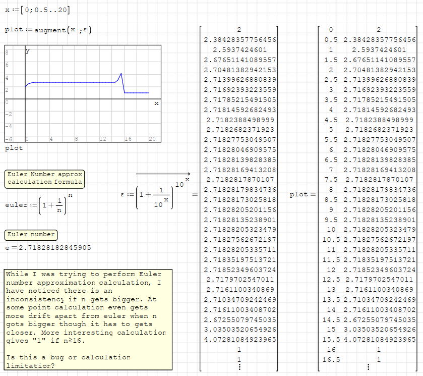

Bug or Limitation? - During euler calculation - Messages
Hi overlord. It's a numerical round-off issue. For example you can get the same issue in excel, with more or less same values.

Davide Carpi 2021/4/1 20:23:00
WroteHi overlord. It's a numerical round-off issue. For example you can get the same issue in excel, with more or less same values.
Thank you Alvaro,
I had only checked this formula only with wolframalpha website.
On it, there were no issues, everything was smooth.
Then I tried it with SMath and get those results.
After your post I calculated with Mathcad and Mathematica.
Results are worse over them. Mathematica can not calculate after exp(7).
On Mathcad results have same spike and they are settled on 1 after it.
So this is basically a limitation. No need to investigate further.
Best regards to you Razonar,
Thanks again.
