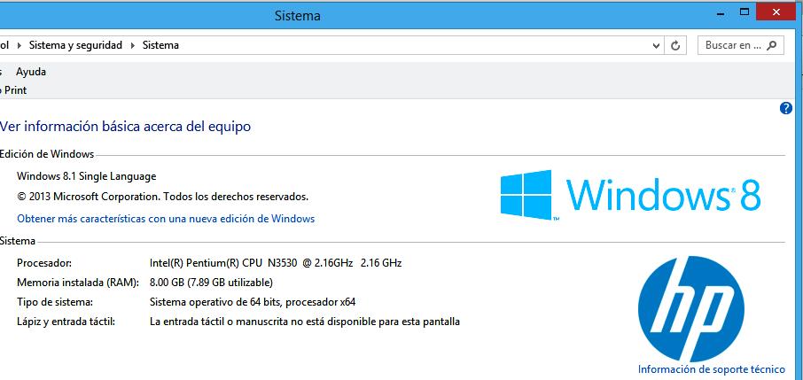

Since Smath Studio 0.98.5908 I can't install on my computer.

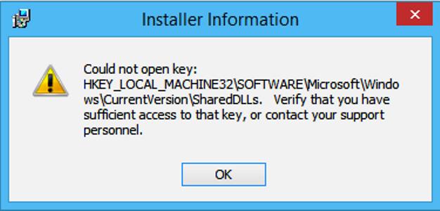

The instalation stops and warn me:

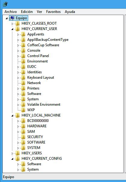

I can see that it has to be with my system, not with Smat Studio , because my system don't have the referred KEY.

Can you check the permissions of HKEY_LOCAL_MACHINE\Software\Wow6432Node\Microsoft\Windows\CurrentVersion\SharedDLLs?
This is the place where your HKEY_LOCAL_MACHINE32 path should redirect to.
My Win7x64 has the following:
Everything is INHERITED from MACHINE\Software\Wow6432Node
Users - read (this key and subkeys)
Administrators - Full access (this key and subkeys)
System - Full access (this key and subkeys)
Creator-owner - Custom (everything checked) (Subkeys only)

If I'm right, the problem isn't with SMath itself.
From my system administration experience, I suppose the following.
Recent SMath may have changed its installation process to not only register its DLLs for system bitness (64 on 64-bit system), but also for 32-bit to prevent acccidental removal in some exotic cases. Or it could be vice versa: it could have earlier always written to 32-bit, and now it writes to both 32- and 64. That could be either Andrey's decision (absolutely correct, I must say), or a change of packaging software - doesn't matter.
However, problems sometimes happen with Windows Installer itself (the OS subsystem that manages installs/uninstalls) that RANDOMLY changes (ruins) registry keys access control lists (ACLs). In a homogenous environment, where ~70 PCs were installed identically, all had identical HW and SW componennts, and so on, once in maybe 1-1,5 years one will suffer from this problem, while all others are OK. And I had this with MS softwares (MSOffice, Live Communicator), AutoCAD, Russian program CTAPT, LibreOffice, etc. Just have to go and manually fix that... Sometimes the fix itself isn't easy, because the system won't let me: it doesn't give me required rights. Had to repeatedly take ownership - reset ACLs - take ownership - ...

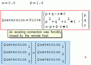

... like dancing with the bear: don't brush your teeth !
What to do? Read advice from experts ... Thanks

Jean, I suppose yours is not "same thing", but a totally different case! You have SMath installed successfully, only Maxima plugin fails to function properly. I'm really sorry, I cannot help here: I know nothing about Maxima.

@Mikekaganski:
Thanks for your help!
I followed your instructions and SS v0.98.5918 installed OK!
@Andrey:
The problem was in my system. Now everything is solved.
Thanks again for your support!
