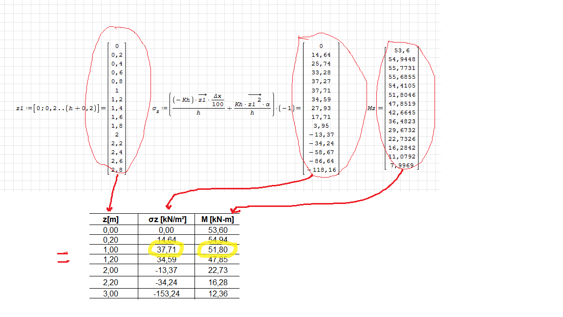

I NEED ADD THE VECTOR IN A MATRIZ AND THEN FIND THE MAXIMIUM VALUE DZ AND THE VALUE OF M WHEN Z IS THE MAXIMUN. PLEASE HELP ME...THANKS

First of all you have to have same length vectors.
Below you can find the solution.
findrows.sm (9.97 KiB) downloaded 959 time(s).
That does it algo style ... collapse FindIndex(M,key) top WS utilities.
FinIdx.sm (9.08 KiB) downloaded 1012 time(s).
