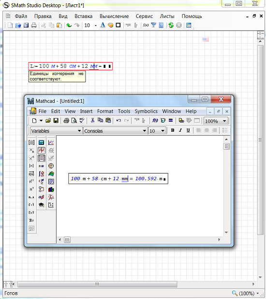

Why this not working?

because of caps?
[albumimg]354[/albumimg]
#3 Posted: 2014/7/11 03:42:26
1,554 likes in 1,864 posts.
I use russian units. They do not work. I don't know is this a bug or not. English units are working fine.

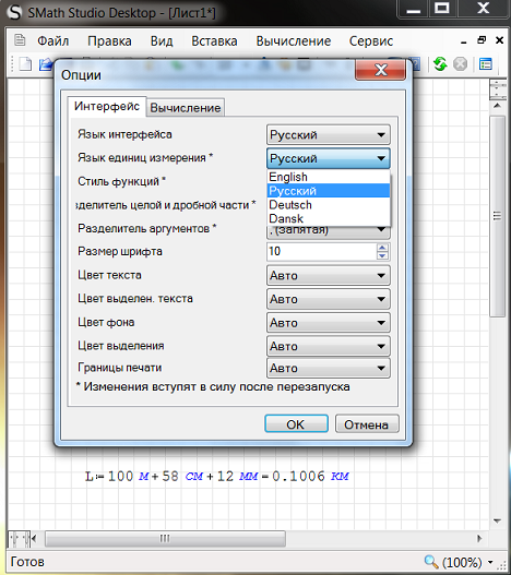

#4 Posted: 2014/7/11 04:21:03
I managed to make a total mess by changing languages. I think this is something connected with Units also.
(SMath nightly build 0.96.3501, x64 Win 7)
See this video please changing languages problem (~5min long)
Until I figured out how to get SMath back, I installed/unisnstalled it few times, Repair it few times etc. - but nothing helped until I I did as presented in the video - changed the language "blindly". Actually, I do not know how to completelly remove SMath from the system and make a "fresh" install?
#5 Posted: 2014/7/11 04:40:15
Thank you Radovan, now it works fine (default was English.).
#6 Posted: 2014/7/11 04:45:24
Thank you Radovan, now it works fine.
Uni, I do not understand . I can not use my languages in this build (neither Serbian Latin, nor Cyrillic) and if you and other people can do this, this must be my computer fault. I will try on some other computers to see if the problem persists.
