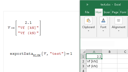

Hello, how are you exporting the text? (save as, a function, ...)
WroteHello, how are you exporting the text? (save as, a function, ...)
I'm using the exportDataxlsx function
Physics is like sex. Sure, it may give some practical results, but that’s not why we do it. (R. Feynman)
Thank you. I cannot reproduce with latest version.
Please check if there is a new version of XlsxImportExport for your SMath Studio version.
Available updates for installed plugins have blue backgrounds.
Tools > Plugins > Online Gallery (option in Local Storage button)
WroteThank you Davide, the plugin was outdated.
