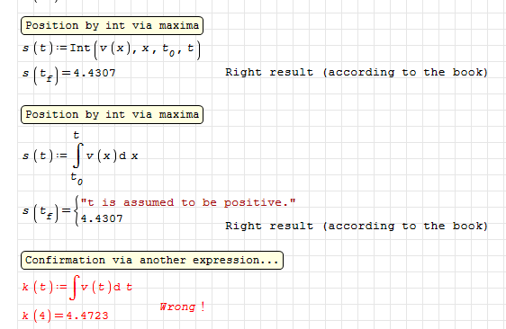

#2 Posted: 2019/6/8 02:39:08
There were mistakes in your file. You should pay attention to definite and indefinite integrals and the function arguments when using definite integrals. See the picture with corrections and hover the expressions in the file to see the difference.

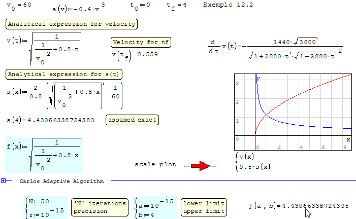

#4 Posted: 2019/6/8 16:24:59
mgklein
mgklein
0 likes in 10 posts.
I see what you did but with respect to "t" and "x". Just to be clear, the definite integral k(t) goes diffent because of the Constant? The constant C=0 and the expression is evaluated for t=4? I think I get it now.
Thanks, Rodovan.
Good idea to save Carlos adaptive integration.
Exceptional numerical integrator that meets Mathcad/Mathsoft Adaptive.
I have exhausted this integrator, it ranges from exact2atleast 6/8 decimals.
Hope it clarifies your questions ... Jean
Sure it does.
I'll test this code.
Thanks, Jean.
