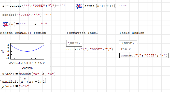

There seems to be something special with the characters generated this way. They will be backconverted to code sequence if used in Maxima region, label region or table region.

Now I know why cint("A" ) does not work. It is a translation problem from SMath to Maxima, see SS-3543.

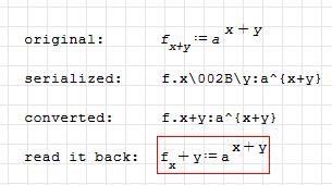

They are special indeed, you can see it by exposing the plain text with copy/paste... The syntax is handled at code level by the math region (like a bbcode or a markdown text)

Because many characters are taken by the math syntax... +-*/.,:;<>(){}@#! (and many more)... converting the code in character may cause trouble while reading back the code.
