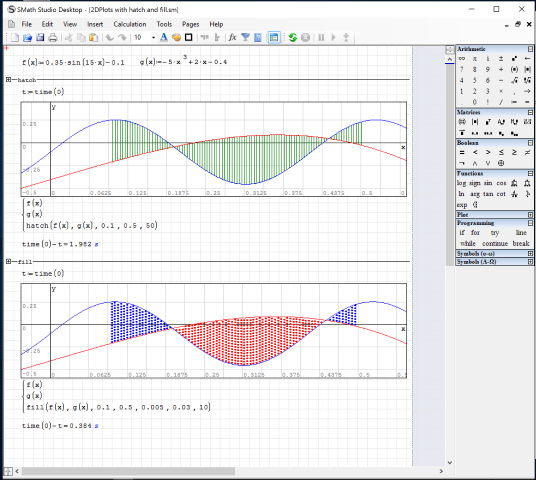

Here is a 'normal' page as it appears-

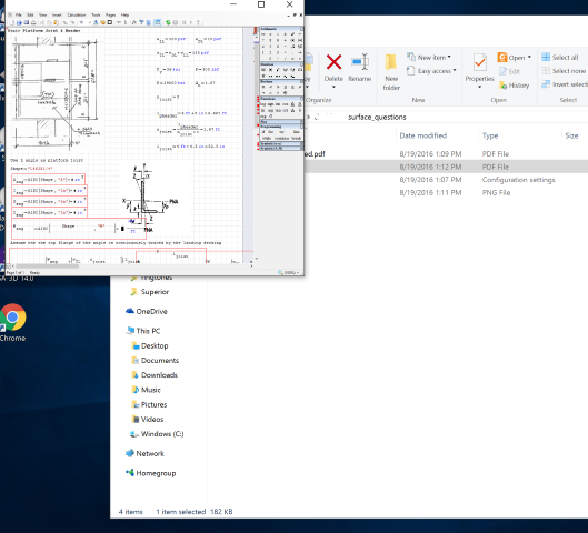

Here is SMath after it resized itself. The crop is the same size as the previous one

So, I've started investigation and I see issue is in ImageRegion. You can disable or delete ImageRegion plug-in using Extension Manager and described issue with scaling will never happen again (SMath Studio will show Dependencies window on file open, but you can just Close it and press Yes in final confirmation dialog).
Regarding errors shown on the worksheet. They are because of "#N/A" retrieved from Excel sheet. Just open Excel sheet you use and correct content in order to fix this "#N/A" error in sheet cells - it will fix SMath worksheet as well.
Unfortunately I didn't manage to find an exact problem in ImageRegion, but it is only question of time...

SMath Studio has no logic to resize itself on error
This behaviour caused exactly by ImageRegion. Do not know why, but it seems this plug-in uses some calls to the Office or to OS which causes switching process-initiator into some safe mode. And because of this plug-in executed in the same process together with SMath Studio we have what we have - system switches SMath Studio to some special mode without asking anyone...
If this error appeared in latest versions only, then we must check previous versions of the ImageRegion to see what was changed their.
