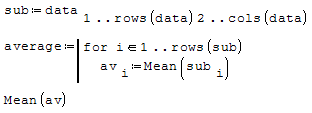

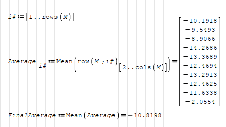

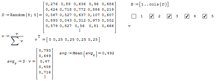

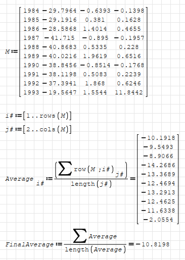

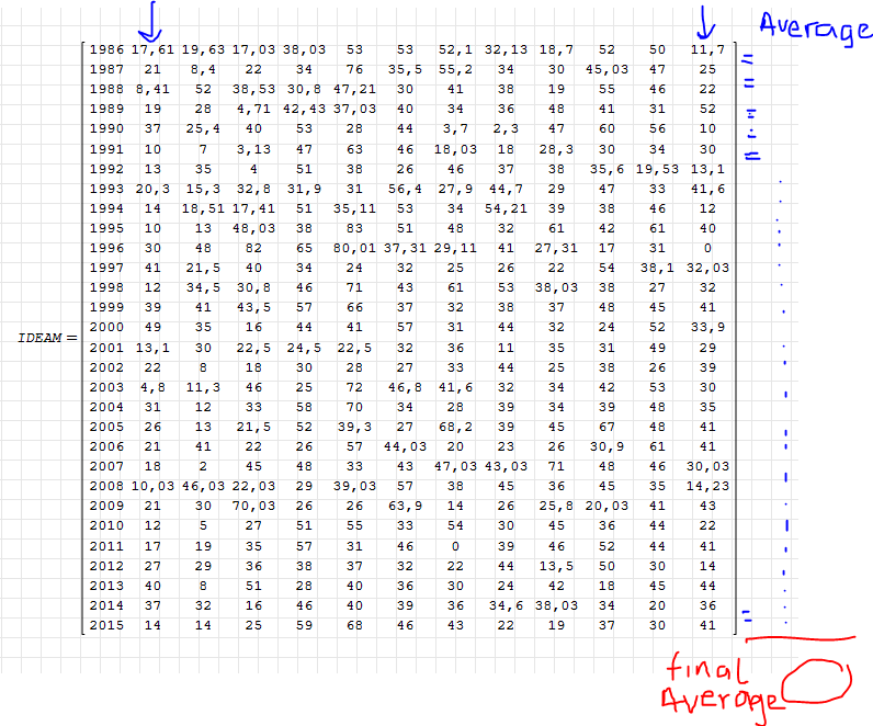

SMath Forum SMath Studio Questions Average 1 Pages (5 items) Average - Messages Go to last post #1 Posted: 2021/6/17 17:18:05 mnorena 0 likes in 13 posts. Group: User hi...I need find the average of each row (without include the first number) and at the end find the average of all averages....thanks for the help #2 Posted: 2021/6/17 17:41:50 Jean Giraud 983 likes in 6,866 posts. Group: User Had you attached the table ... job done.Cheers ... Jean #3 Posted: 2021/6/17 17:47:26 overlord 580 likes in 1,349 posts. Group: Moderator Wrotehi...I need find the average of each row (without include the first number) and at the end find the average of all averages....thanks for the helpLong versionShort version #4 Posted: 2021/6/18 08:02:29 Jean Giraud 983 likes in 6,866 posts. Group: User WroteHad you attached the table ... job done.Average.sm (9.28 KiB) downloaded 643 time(s). #5 Posted: 2021/6/18 08:07:34 Martin Kraska 1,308 likes in 2,221 posts. Group: Moderator Another version with scalar product.Easy to adjust to arbitrary subsets of columns.avg.sm (6.53 KiB) downloaded 650 time(s). Martin KraskaPre-configured portable distribution of SMath Studio: https://en.smath.info/wiki/SMath%20with%20Plugins.ashx 1 users liked this postSerg 2021/6/18 08:33:00 1 Pages (5 items) New Posts No New Posts
