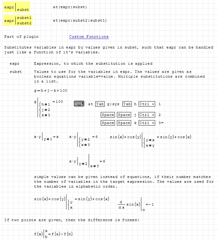

As on how to gain info: If you install the preconfigured portable distribution (see signature), the [?] button in the toolbar leads to a interactive manual.
The notation you ask for is provided by the at() function from the custom function plugin.
![2017-09-11 10_53_29-SMath Studio 0.98.6437 - [at.sm].png](/zh-Hans-CN/files/Download/mGscpv/2017-09-11-10_53_29-SMath-Studio-0.98.6437---[at.sm].png)
at.sm (21.74 KiB) downloaded 1080 time(s).
