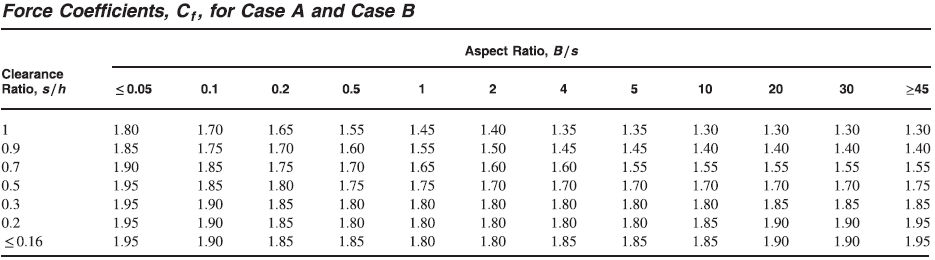

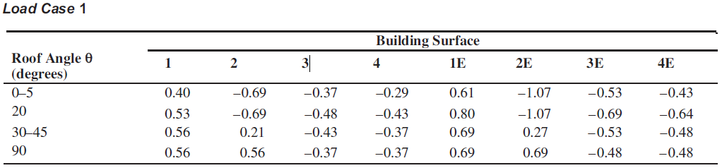

I'm pretty sure it's possible and saw it somewhere here. How do I put this in a single matrix, along with the descriptors like "roof angle, "1", "2E",...etc. and use it for interpolation. Well I can get by using a single column matrix as a work around but I guess I want a more compact looking solution, if that makes sense.

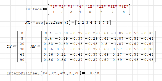

598 likes in 1,380 posts.
Look for InterpBilinear() function.
You can find more info in Reference Book.

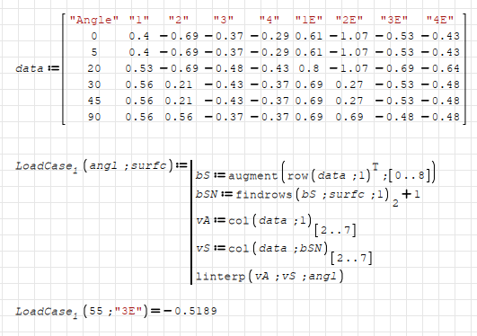

#5 Posted: 2024/1/17 20:45:37
Using linterp() with a function is another way.
Function selects column according to input.
linterp_select.sm (8.1 KiB) downloaded 1370 time(s).

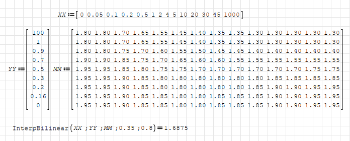

I'm quite satisfied with the InterpBilinear function. I'm exploring Jean's and overlord's additional suggestion but still it was already solved for me. Another question is that would that still work if I had to do interpolation in both the column values and row values such as in case below.
From what I understand, InterBilinear() seems incapable of doing what I aim to do. Do you have any suggestions?

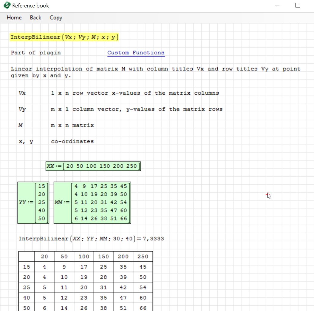

#7 Posted: 2024/1/18 18:37:38
1,355 likes in 2,271 posts.
#8 Posted: 2024/1/18 19:10:51
From what I understand, InterBilinear() seems incapable of doing what I aim to do. Do you have any suggestions ?
If, I understand your request,
ForLoop algo style will do ... last example page 10.
Interpolate [Linterp, Spline2D].sm (212.07 KiB) downloaded 1265 time(s).
#9 Posted: 2024/1/18 20:25:30
On the contrary, InterpBilinear() does exactly what you seek.
It interpolates both row and column values.
PS: I added extra values to accommodate ≤ and ≥ boundaries.
