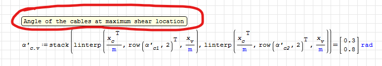

It would be good if SMath offered the functionality of formatting the description region, including: (i) font, (ii) background (yellow is cool, but not always applicable), (iii) frame/boundary (on/off).

Thanks Jean. I think we misunderstood each other. I was proposing to change the background of the description region/field, rather than the input region, as your example shows. Something like this:

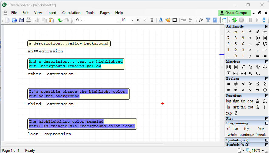

It's not possible change the background color of description region.
Only it's possible change the color which the text is highlighted inside a description region.
Please see this video:

#12 Posted: 2023/9/20 10:43:48
598 likes in 1,380 posts.
This is not persistent. Possibly just a visual bug.
Background color changes to description text is not saved.
I checked with an external text editor, no data saved related to it.
They are same with yellow background and colorful highlighted.
When you save file, close it and reopen it all colors will revert.
Either to latest selected background or yellow.

It is a very strange behavior...
But, before I posted, I did that check you mention. I saved the file, then closed SMath, reopened, and the colors remain...
#14 Posted: 2023/9/20 11:23:01
Close smath, reopen with a blank page, change background color to white, close file without saving.
Now reopen smath with the file you saved, background highlight should be gone.
Oscar Campo 2023/9/20 11:37:00

Yep..
you're right...
it's only a bug
Thanks!!

Previusly reported here. No change in the background of description region, only the text is highlighted, but is not permanent, was checked as a bug here

#19 Posted: 2023/9/20 19:29:41
Not a bug, just a fact Smath does not save this Windows facility.
Smath saves itself only, thus not Windows background.
All that said, simply a local convenience.
However, superb for publishing *.PDF document.
Maths Description Background Image.sm (53.7 KiB) downloaded 1467 time(s).
