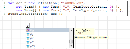

#2 Posted: 2017/3/23 05:05:17
1,532 likes in 1,838 posts.
Yes, you can.
Script:
Show Spoiler

Thank you again - now I see that it can be done but your answer results in two more questions:
1) How are you including C# code in Smath region? Is it just print screen or real code in some type of region which is evaluating on fly? Looks like magic for me (in MathCAD it is impossible to do such things).

#4 Posted: 2017/3/23 07:06:40
Quote
Yes, the code is executed on the fly. This is just a Script region.
Quote
2) You are using Definition and Store classes. During searching in example plugins I found that there are used mainly in customizable controls. I am developing some sort of functions by implementing IPluginHandleEvaluation interface.
This is features of Script region. In your case, you have to write it differently. I just showed that this will work.
