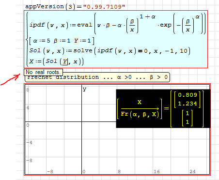

Hello Jean,
It seems something was wrong here - "no real roots".
#3 Posted: 2019/7/24 21:17:28
"No real roots" SS 7109 is a bug wrt that version.
Surprising it does not complain elsewhere the solve bloc is called ?
The attached is SS 6179.
Salut Radovan, thanks for reporting ... Jean.

Hello Jean,
Thanks Radovan ... no bug: just bad construction.
The main work sheet doctored.
α, β were consumed in the Pt100 thermometer.
Solve Inverse Symbolic Suite READ First Copy.sm (289.33 KiB) downloaded 1252 time(s).

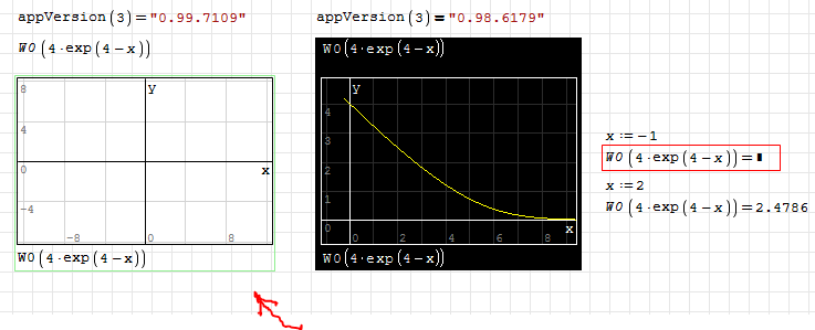

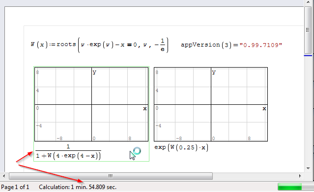

Hello Jean,
Hmm...I am not sure if it should be this way but this has been working to long.
I just opened the worksheet and it seems that it get stuck at this graph.
The SMath version was 0.99.7109

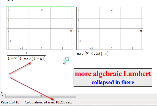

#10 Posted: 2019/7/26 08:54:19
1,443 likes in 2,935 posts.
The problem is that W(4*exp(4-x)) returns an error "index out of matrix bounds" if x is negative (check it on the canvas). Then this triggers the infinite calculation time in the 2D plot.

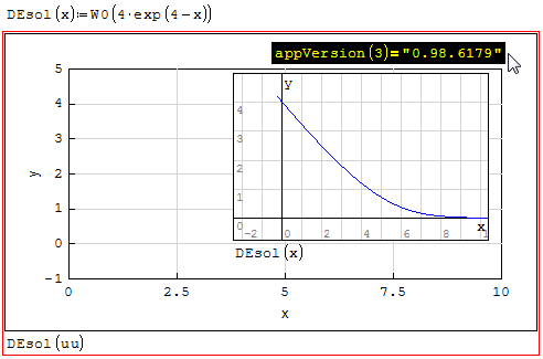

#11 Posted: 2019/7/27 18:27:24
Solution of this demo DE is wrt Lambert W0(x)
I attempted W1(x) "Division by zero"
On the other hand: Lambert [W0(x0, W1(x)] do not vectorize
but tabulates for loop discrete. Wait and see Radovan next visit.

#12 Posted: 2019/7/28 02:41:36
I simply do not understand why is this happening (triggering the infinite calculation time in 2D plot) and think that in 7109 this behavior is wrong regarding the 2D graph.
I think it should be considered a bug. If the x-y point can not be calculated it should be just skipped, nothing else. I also think that in 6179 is applied that behavior. The X-Y plot is doing this just right.

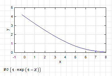

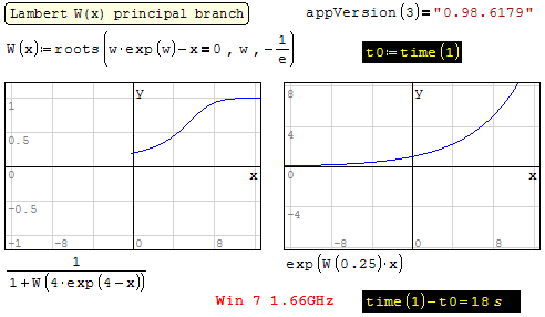

#13 Posted: 2019/7/28 10:39:03
A desperate case: Quick plot 6179 just fine
X_Y red does not solve "roots" on its own canvas.
Interesting but does not cut the mustard yet .

Yes Radovan but so gorgeous solving on the running canvas.
Something like Mathcad 'root', much easier to implement.
Inst_Mach Number Pitot.sm (187.41 KiB) downloaded 1184 time(s).

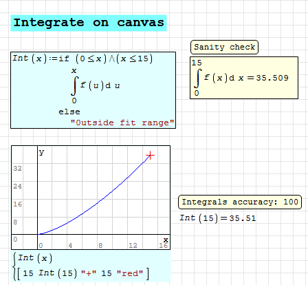

Function roots() will do the job in this example. But Mathcad root() function will not let you down in the case of srict numerical cases (I am repeating myself to often...).
By the way, there is an error in Int() function (z not defined). I think this was also already mentioned few times...
#17 Posted: 2019/7/29 08:37:58
Quite right Radovan, transit via 'z' not needed 6179.
Pitot Mach was one of my very first SS 5346.
