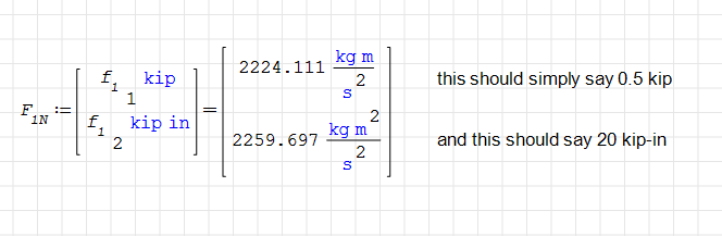

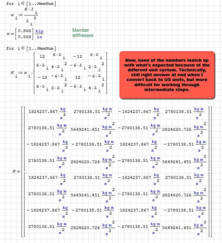

I've been using SMath for several years now, and I generally like it. But one shortcoming compared to Mathcad has always been the units for the US, even though consistent and automatic unit conversion is SMath's most helpful ability compared to something like Excel for engineering calcs. Most of the time, I can just go through the extra steps of typing in the units I actually want every time SMath displays the results in metric units. But I can't do that in matrices. If everything in the matrix is the same unit, then I can type in my USCS units outside the matrix and everythign is good. But sometimes I have mixed units like with stiffness matrices, and I end up with results like below with no way to force them to display correctly. Even these are the result of an extensive workaround earlier in the worksheet where I basically made all my inputs dimensionless and had to keep track of units manually, as some of my stiffness matrices will have various elements in kips, kips/in, and kip-inches, all in the same matrix and not segregated by row or column. I've tried using the "Imperial" option in the user settings file several times over the years, but that is worse than leaving it metric and manually changing every unit in every formula. I've tried editing the Units.xml file, but I'm not sure how to go about that. Is there any guidance on how to edit that? Long story short, I would really request a better ability to define default units, especially when dealing with matrices. They need to be able to have certain units on a per-element basis.

Jason McCool 2022/10/31 09:18:00

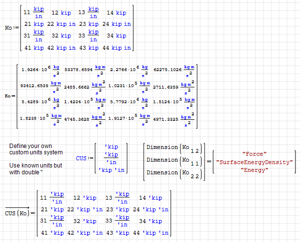

Hi Jason. This is a workaround. You can't show a column vector with mixed units, but a row vector.
row_vec_mixed_units.sm (3.77 KiB) downloaded 1567 time(s).
Oscar Campo 2022/10/31 00:10:00, sergio 2022/10/31 05:31:00

Martin, I agree. I would rather not have to edit Units.xml, but I'm not sure how else to accomplish it besides preventing SMath from even knowing those other units exist. Other than occasionally getting into some Eurocode calcs for structural mass timber connections, 99% of my work is in the US where metric is never an issue, and I'm basically the only one at my office (or in my grad school class, which is actually where I'm getting more heavily into the matrices now) that uses SMath or any of the calcs I develop from it. Office colleagues use Excel, and classmates use Mathcad. So a custom xml file might not be a big deal for me. I would like to see some more control of units moved into the program UI where you don't have to exit the program and edit settings files just to switch the default from Metric to Imperial or vice versa. But then the switch to Imperial has never really helped me because it always wants to use units I don't want, so I end up retyping all my units just as much as I did when it was set to metric, so I normally just leave it metric in the User Settings file.
Alvaro, thanks for the workaround suggestion. I don't think it will help, but let me add some more context. These stiffness matrices are (currently) 4x4 matrices with bending stiffnesses in 2 positions of each column and rotational stiffnesses in the other two positions. Previously, for truss stiffness matrix work, I was able to just apply kips/in outside the matrix because they were all axial stiffness terms, but now I have more degrees of freedom and more terms, and different units among the terms. This week, my class is proceeding to frames that will add more degrees of freedom and more variety of units among the different terms. See below for an example where I made everything unitless based on my input being in a specific input (length in inches, etc) so that my numerical values are correct in all terms, and what the same matrix looked like before when I had units assigned. I would like to see the units assigned and carried through if possible, because it is extra work to make sure I apply the correct units to my results at the end based on which elements were used from the matrix (e.g. is the value in my final system matrix based on the bending or axial stiffness value? One or the other might get canceled out because of boundary conditions, and that elimination happens in subsequent steps.) So while the row vector may be a workaround for the smaller vectors I'd initially shown in my first post, the matrices those derive from are bigger and more complicated and are actually the root problem, and I don't think that would be an option for those. But thank you for the suggestion!

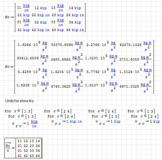

Hi Jason. This is a workaround for show mixed units in a matrix.
matrix_mixed_units.sm (18.34 KiB) downloaded 1568 time(s).
Oscar Campo 2022/10/31 13:22:00, sergio 2022/10/31 14:23:00

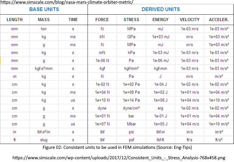

The key scientists behind the Apollo and earlier shots were using metric (ie not imperial): https://www.eclipseaviation.com/the-metric-system-a-key-to-the-success-of-the-apollo-moon-landing/
The cost was that they had to use precious computing resources to display the metric calculations in imperial (again, 'the cost of imperial' ): https://ukma.org.uk/why-metric/myths/metric-internationally/the-moon-landings/
The cost of mixing measurements continued: Metric vs Imperial Units: How NASA lost a 327 Million Dollar Mission to Mars: https://everydayastronaut.com/mars-climate-orbiter/
The latest moon shots are metric only: https://science.nasa.gov/science-news/science-at-nasa/2007/08jan_metricmoon/.

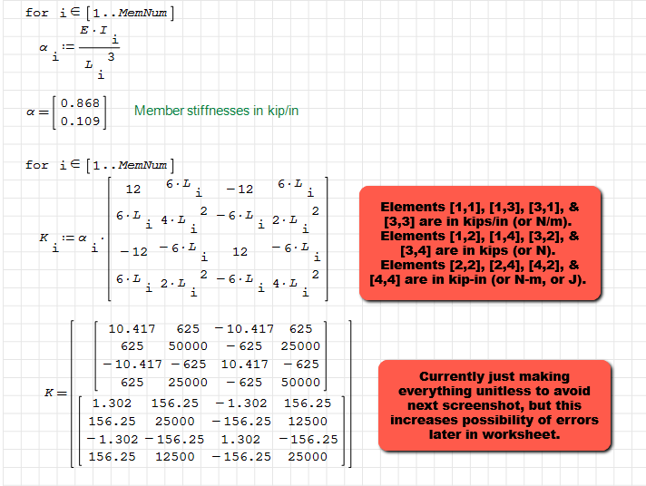

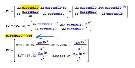

...But sometimes I have mixed units like with stiffness matrices, and I end up with results like below with no way to force them to display correctly...
Notice that Jason does not want kg to be replaced with lbm , nor does he want m to be replaced with ft, but rather to have 2224.111 ㎏ ㎨ reported as 0.5 kip. From a metric standpoint, I would presume the result of 2.22 kN would be preferred.
What are the 'solutions' to this limitation:
  1. make inputs dimensionless
    • PRO:
      • results of force will not report values in terms of seconds
      • Data will be Compact
  • CON:
    • have to keep track of units manually
    • harder to perform quality control
    • allows introduction of errors
  • utilize custom units
    • PRO:
      • easier to preform quality control
    • CON:
      • requires more setup
      • inability to force units to simplify (e.g., ㎏*㎨ --> kN)
      • custom units will be at odds with built-in units (i.e., 'inchesin )
  • Developers to better support Imperial units as default
    • PRO:
      • results will be reported in imperial units
    • CON:
      • results will not be reported as expected (e.g., force will still be reported in terms of seconds)
      • inability to force units to simplify (e.g., lbm*in/s² --> kip)
      • A current bug/error to the program for (pending 10 years), not easily fixed...
  • Developers to allow users to define a customize set of Output Units for all/any UnitsDimensions
    • PRO:
      • results will be reported in units you want to see
    • CON:
      • will require extensive resources/time to develop
    This feature request is with regards to Option #3, but this will actually do very little to actually produce the intended results. Option #4 would address a huge limitation of SMath, but implementing such a feature is easier said than done. I would avoid Option #1 as managing units separately is prone to errors.
    Therefore, the best path forward would be to implement a version of #2, where you can review your math in the context of a pseudo unit (reference: https://en.smath.com/forum/yaf_postsm79742_Usable-default-units-for-US.aspx#post79742)
    -Kenny Lemens, P.E. ᵂᴵ

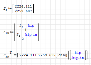

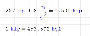

    Quote
    Notice that Jason does not want ... but rather to have 2224.111N reported as 0.5 kip.
    Sorry Kenny & Jason, I suspect that I'm not understanding this issue fully. SMath appears to be handling the conversions and units display correctly:
