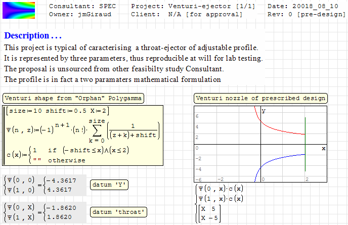

WroteThanks.Interesting how you've combined a background image
Do you really know what you want ?
Such a big horrible logo at the top of each page as you ask before ?
Or my suggestion from a saved *.sm that you open and immediately
copy/paste in blank sheet, close the original and go for the project ?
BTW: you don't have to save the logo image as whatever [*.PNG, *.BMP]
you capture, the word is capture from the screen and paste in Smath
work sheet. My preferred capture tool is WinGrab [freeware].
Did you open my attachment Smath document ?
Did the PDF opens ?

Add extra in the Header: &[DATE] &[TIME] - &[FILENAME] - [Rev_1: Geoff]
As plain as possible, text white background [254,254,254]
Once your company logo has been capture and pasted,
it is resident in the Smath work sheet, i.e: the saved Cartouche template.
Assume your are the Grand Savant of something, I'm your client.
For sure, if your maths are too much for me, I will have the design proofed
by some independent competence that will surely dislike the Cartouche at
the top of each page, particularly if I give him a PDF.
All those are just comments. Cheers ... Jean
