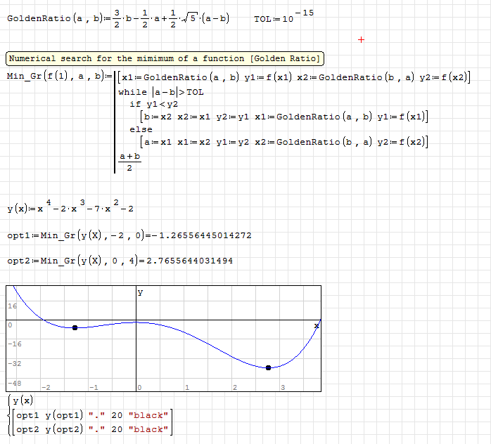

Thanks Davide,
"GoldenSectionSearch" works fine. I have added the Mathcad 11 equivalent,
just a bit more compacted. The Mathcad "While" loop is self indexing but
NOT attempted to code, because your coding is more complete "target" min/max.
In the attached work sheet, I give the solve block [much faster].
Nice to know how "GoldenSectionSearch" works under the hood.
I will visit more from your work sheets.
Interesting the implicit coding:
Cheers, Jean
Golden ratio.sm (63.22 KiB) downloaded 1407 time(s).

Very nice Jean
As for the truth it is possible to code Min_Gr like in mathcad; you need SMath 0.98, since previously the parsing order of assignments inside matrices was made in reverse order (that makes it possible to code it even in SMath 0.97.*, but in a cucumbersome way)

Yes Davide !
Can't be more right. Smath official 5346 does not digets the Mathcad code as you have
implemented. It made me shovel the clouds for a while ! While loop !
