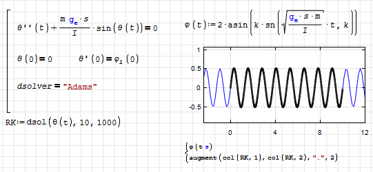

#8 Posted: 2025/2/28 02:06:25
1,078 likes in 1,749 posts.
... Firstly, I believe you changed the sn( 1; 2) function I utilized to a simpler sin() function, I must ask if that was mostly due to simplification of the analytical processes or if there was any other reasoning behind it. ...
Because I don't know how to find the derivative of the arcsin of a complicated Jacobi elliptical si expression. Actually, Wolfram neither. In this version I restored the function sn and the derivatives are found numerically.
... Secondly, you refer that phi(t)' and phi(t)'' have different units and, therefore, H(t) will be incorrect. How could one attempt to resolve that issue?
The way it is written, the units of H do not match. However, I do not know how to fix them because I have no idea what H could be. Is it the Hamiltonian? If you provide some theoretical framework, maybe I can understand a little better what you are trying to solve. Also, there are many unused variables: volume, thickness, beats per minute, diameter...
Numerical and symbolic solution, for what I suppose is the problem to be solved:
Frequency Analysis_v2.sm (189.94 KiB) downloaded 977 time(s).

#11 Posted: 2025/3/2 07:38:48
A long time ago I addressed the problem by writing this scilab script ...
Hi Sergio. A solution, I guess that it is the same.
Campana di Pompelmo.pdf (524.95 KiB) downloaded 541 time(s).
Campana di Pompelmo.sm (1.01 MiB) downloaded 977 time(s).

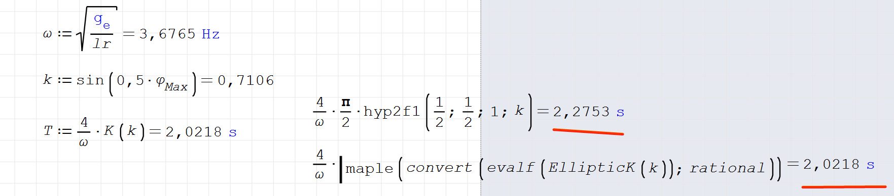

#15 Posted: 2025/3/3 02:53:07
116 likes in 332 posts.
Alvaro thanks again.
Only a annotation for the calculation of the "K" function: you gave two methods (indicating what you think preferable); The other method numerically provides the same value provided by Scilab and in fact two rather different periods of oscillation are obtained as indicated below (2.02 s against 2.27 s).
I have no mathematical knowledge so high to be able to evaluate this difference that does not seem to me to be of an exclusively numerical type.

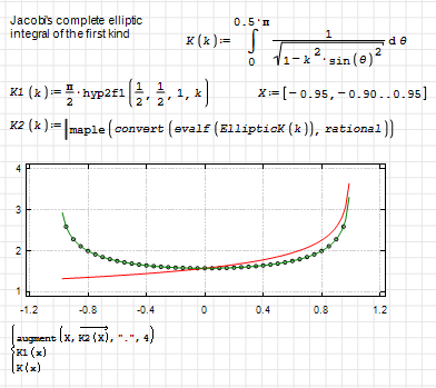

#16 Posted: 2025/3/3 04:24:39
Hi Sergio. You're right. I couldn't find the function among the plugins, so I looked for equivalent ways of writing it on the Wolfram functions site. However, numerical problems with a 4-variable function can be really serious. Surely there is some other, more accurate way, and one that doesn't involve using Maple just to evaluate a function, no matter how special it is.
https://functions.wolfram.com/EllipticIntegrals/EllipticK/26/01/01/
Edited: With this version of K it seems to work fine
Campana di Pompelmo v3.sm (1.02 MiB) downloaded 985 time(s).
