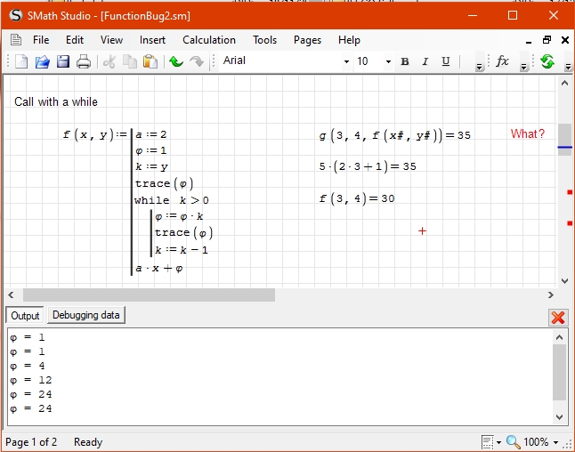

... and issues in composite functions with loops.
FunctionBug2.sm (17.71 KiB) downloaded 1270 time(s).
FunctionBug2.pdf (76.58 KiB) downloaded 728 time(s).
sergio 2020/11/18 16:45:00
#3 Posted: 2020/11/18 16:47:05
1,123 likes in 1,795 posts.

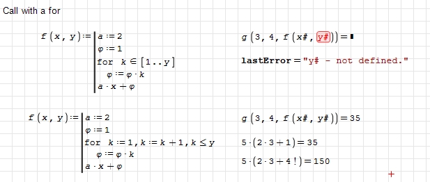

Debugging with trace(), what I see is that when calling g, f takes phi=1, (this is the first phi=1 in the output window) but don't do the loop. Calling f isolated shows another phi=1 and subsequent values for phi.
With for(3) gives an error, so I can't debug that. Additionally, calling with for(4) seems to have the same behavior than while.
