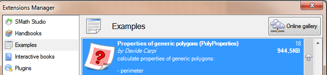

If you are interested, in the Extensions Manager (Tools > Plugins > Examples [Local Storage > Online Gallery]) there is a worksheet dedicated to to polygons' properties - just to not reinvent the wheel
![2015-02-20 22_02_34-SMath Studio Desktop - [Page2.sm].png](/zh-Hans-CN/files/Download/XNkege/2015-02-20-22_02_34-SMath-Studio-Desktop---[Page2.sm].png)
Thanks Gerry and Davide for your replies.
Gerry I fixed the function based on your answer and it works fine.
Davide your example sheet is awesome. You are right there is no point in reinventing the wheel. I will go through it in detail and put it in use in my future development of sheets.
