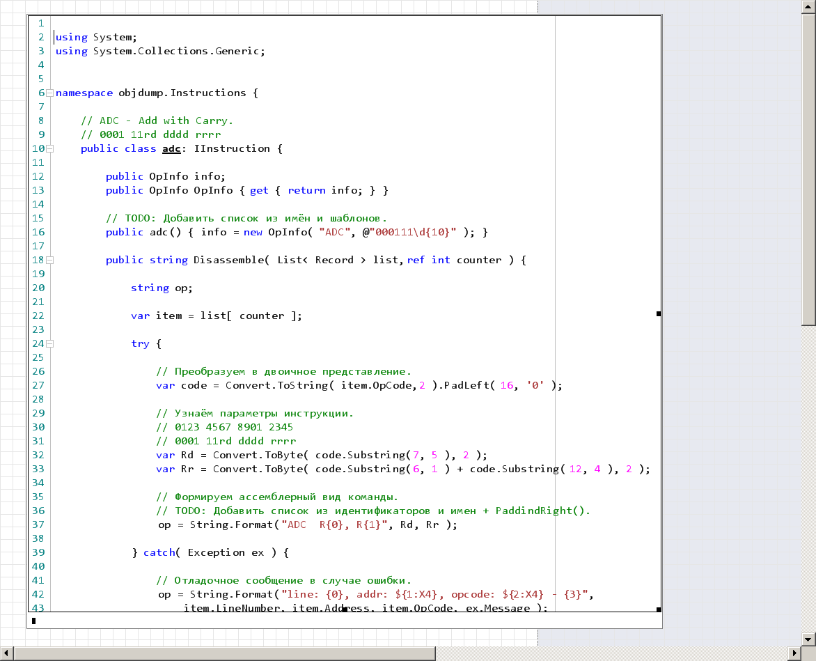

Unfortunately, no. But I can tell how to simulate OnKeyPress().
public class KeyCodeToAscii {
[DllImport("User32.dll"
public static extern int ToAscii(int uVirtKey, int uScanCode, byte[] lpbKeyState, byte[] lpChar, int uFlags);
public static extern int GetKeyboardState(byte[] pbKeyState);
public static char GetAsciiCharacter(int uVirtKey) {
var lpKeyState = new byte[256];
GetKeyboardState( lpKeyState );
var lpChar = new byte[2];
if ( ToAscii( uVirtKey, 0, lpKeyState, lpChar, 0 ) == 1) {
return Convert.ToChar( ( lpChar[0] ) );
} else {
return new char();
and
public override void OnKeyDown( KeyEventArgs e ) {
var keyChar = KeyCodeToAscii.GetAsciiCharacter( e.KeyValue );
OnKeyPress( new KeyPressEventArgs( keyChar ) );
public void OnKeyPress( KeyPressEventArgs e ) {
![2014-04-19 19-27-00 SMath Studio Desktop - [Лист1 ].png](/zh-Hans-CN/files/Download/R2pFeF/2014-04-19-19-27-00-SMath-Studio-Desktop---[%D0%9B%D0%B8%D1%81%D1%821-].png)

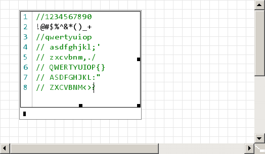

Davide Carpi 2014/4/19 09:37:00
WroteUnfortunately, no. But I can tell how to simulate OnKeyPress().
Really good hint... starting from here, I've deeply searched and in the end I've found this: http://stackoverflow.com/questions/370754/convert-a-keycode-to-the-relevant-display-character
Here a small adaptation:
using System;
using System.Diagnostics;
using System.Windows.Forms;
using System.Runtime.InteropServices;
using System.Text;
namespace ComboBoxListRegion
/// <summary>
/// hook adapted from: http://stackoverflow.com/questions/370754/convert-a-keycode-to-the-relevant-display-character
/// </summary>
public class KeyboardHelper
[DllImport("user32.dll", CharSet = CharSet.Unicode, ExactSpelling = true)]
private static extern int ToUnicodeEx(
uint wVirtKey,
uint wScanCode,
Keys[] lpKeyState,
StringBuilder pwszBuff,
int cchBuff,
uint wFlags,
IntPtr dwhkl);
[DllImport("user32.dll", ExactSpelling = true)]
internal static extern IntPtr GetKeyboardLayout(uint threadId);
internal static extern bool GetKeyboardState(Keys[] keyStates);
internal static extern uint GetWindowThreadProcessId(IntPtr hwindow, out uint processId);
public static string CodeToString(int scanCode)
uint procId;
uint thread = GetWindowThreadProcessId(Process.GetCurrentProcess().MainWindowHandle, out procId);
IntPtr hkl = GetKeyboardLayout(thread);
if (hkl == IntPtr.Zero)
MessageBox.Show("Sorry, that keyboard does not seem to be valid."
return string.Empty;
Keys[] keyStates = new Keys[256];
if (!GetKeyboardState(keyStates))
StringBuilder sb = new StringBuilder(10);
int rc = ToUnicodeEx((uint)scanCode, (uint)scanCode, keyStates, sb, sb.Capacity, 0, hkl);
return sb.ToString();
and
string keyChar = KeyboardHelper.CodeToString( e.KeyValue );
if (keyChar != String.Empty)
OnKeyPress( new KeyPressEventArgs( (char)keyChar[0] ) );
This works also with Cyrillic and Greek
