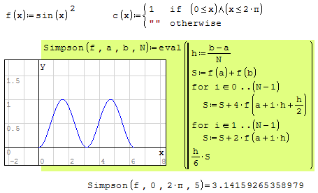

You may retain 3 of them:
1. Finite Differences for noisy well populated data sets.
DO NOT smooth before applying FD. By "noisy" we mean as collected
rather than Quiz Noise having no project meaning.
2. Simplex is hyperfast, somewhat delicate to manage.
You can safely work on low range 's' [7 .. 11 typical]
3. ∫Adaptive(f,a,b,iter,TOL) universal Grand Champion
Thanks again Carlos for this competitor to all advanced CAS.
Enjoy, use wisely ... Jean
Integrate Compendium_24 Simplex-Adaptive Reconciliate Copy.sm (276.69 KiB) downloaded 1225 time(s).

... please, recycle the previous version refreshed by this one.
Two more documents belong to this tool box.
Finally, here is the Mathcad/Mathsoft Adaptive.
At this point: the Smath integrator is obsolete, cumbersome
prone to dramatic errors. It should be evaporated from SS .
Integrate Compendium_24 MCDadaptive Read EDU.sm (51.74 KiB) downloaded 1101 time(s).
Integrate Compendium_24 Simplex-Adaptive Reconciliate Copy.sm (278.36 KiB) downloaded 1169 time(s).
Integrate Compendium_24 Bisection-Adaptive Read EDU.sm (97.47 KiB) downloaded 1124 time(s).
