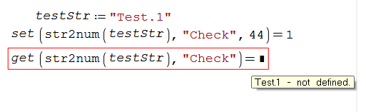

Hey Alvaro,
I was testing out your methods with the inclusion of loops and it seems that I can't create a variable beforehand and assign it, it has to be empty. Do you know a way around this?

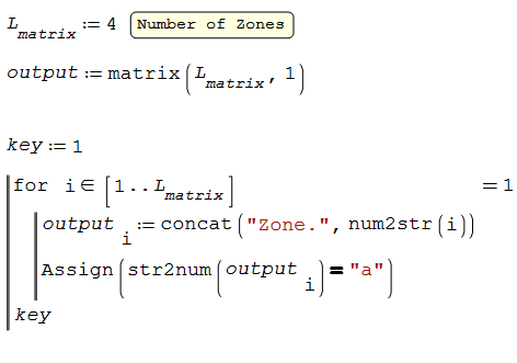

This is ultimately what I am trying to do with these functions, where I can get a mutable array of "Zones", each with their own properties (ie. area, x/y location etc.)

I figured it out, just don't know a way around it. Since I'm calling str2num(output_i), it's giving me the value of that expression and not the variable itself.

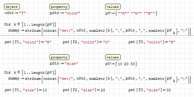

Yep. You need to call str2num at the worksheet level. Something like this
obj_set_get.sm (18.86 KiB) downloaded 1159 time(s).
Also, I'm go to modify the code for accept set or collections.
