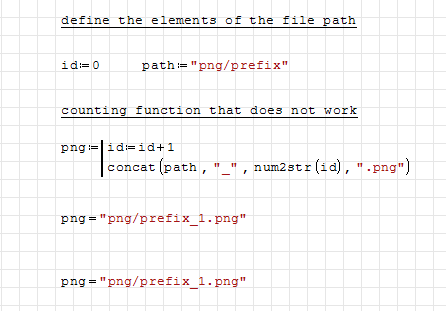

Would anyone know if there is a way to define a variable or a function that increases in value by 1 every time it is called?
I am trying to set up automatic naming scheme for the image output of my excel_PNG plugin. It takes a filepath as an input to be used when saving generated png. What i need is to generate the filepath string which is different every time its called. It also needs to be consistent (i.e it cannot change for a particular function call every time worksheet is calculated) so random() will not work.
Ideas? Unique consistency of the value for a certain position within workbook is s the goal.
Here what i tried, predictably without success.
ID.sm (3.8 KiB) downloaded 1107 time(s).

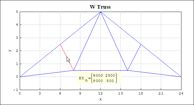

#13 Posted: 2016/2/25 01:30:04
I understand your point of storing dead stuff...
Smath is live for Engineering/Edu/Sciemtific ...
What's the point to read that dead image if the construction is not exemplified ?
There was a long thread on that one, particularly about not a "parrot plot"...
Maybe not yet finished ! ? I admit, humbly, I'm not a "bright spark".

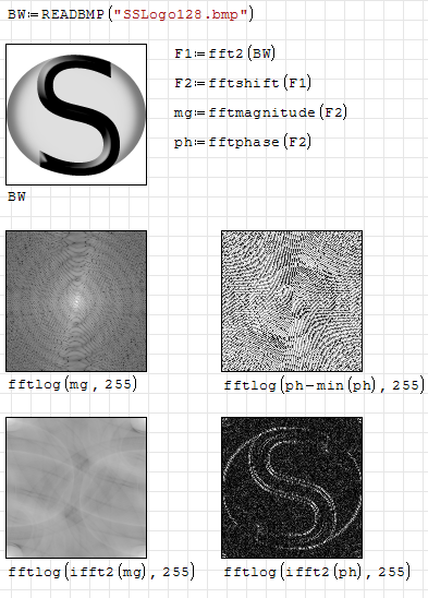

Jean, I think that both the purposes are OK and can/must coexist
If one needs only to show an image on the canvas, there's no need to fill the worksheet memory or the file itself of useless data.
If one want/needs to process images, this is another story (BTW, many thanks for all the worksheets you share here in the forum )
IMHO as it is now processing images on the worksheet is reliable only for small images (only teaching purposes); using plugins you can boost the math speed or build a region that can do all "in-place" but this is not funny because the math is hidden under the hood. A "picture operator" or a boost in matrices management is needed and can be done only by Andrey (here we are focusing on images but the issue may be the same in any signal processing problem, such as audio, wind, etc...).
The example below is ok for a 128x128 image, but too slow for a 256x256 image (or bigger), using greyscale images, and functions driven in plugin: fftmagnitude (abs() extended to matrices), fftphase (arg() extended to matrices), fftlog (basically a logarithm function for matrices); to run all except the ffts in the canvas (in a reasonable time) 128x128 is too big.

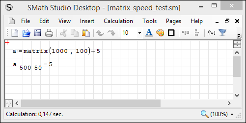

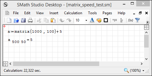

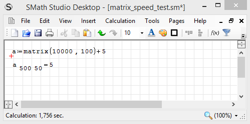

#18 Posted: 2016/2/25 17:59:28
2,340 likes in 4,041 posts.
Davide, was this ever brought up to Andrey? Matrix manipulation is an important bit for practical use of SMath and right now it is on a slower side.
Thank you for noting this. Just reviewed a code and found possibility to make great improvement to some operations with matrices.
This is latest available public build of SMath Studio (see the calculation time).
This is a new build I've just created locally (changes not related to matrix() function - the overall speed of communication between SS Core and built-in symbolic library improved):
...and even bigger:
Will see if I can found some other places to improve.
