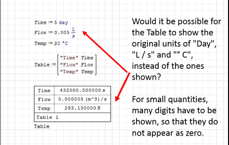

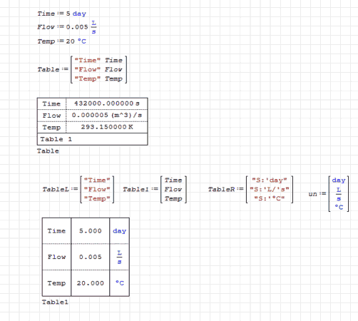

Will it be possible?
Units_Table.sm (7.85 KiB) downloaded 1168 time(s).
Carlos

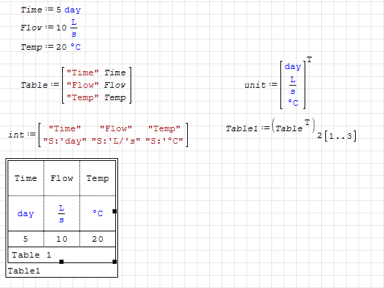

sets the header and units matrices

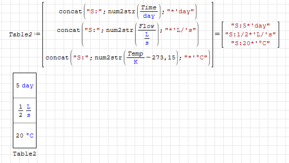

Thanks Sergio:
You made me remember the solution that Martin Kraska gave me, but I can not put a header on it.
Do you have any suggestion?
Units_Table_r2.sm (15.19 KiB) downloaded 1229 time(s).
Carlos
#4 Posted: 2018/3/22 06:35:19
127 likes in 342 posts.
I thought about this (string manipulation)
but num2strtransforms into fractions
Davide Carpi 2018/3/22 08:17:00
Use var2str() from CustomFunctions instead

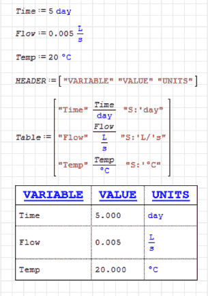

Thank you very much to everyone for your help,
I already managed to make the table as I required it.
Units_Table_r3.sm (9.19 KiB) downloaded 1214 time(s).

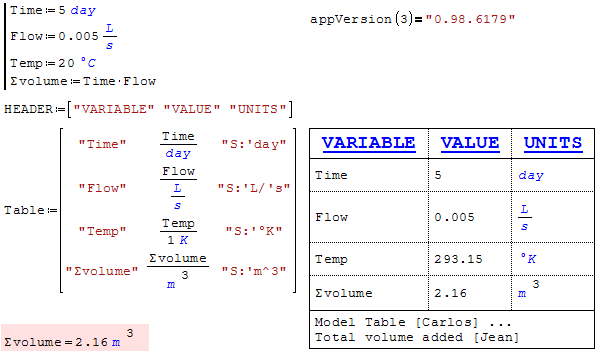

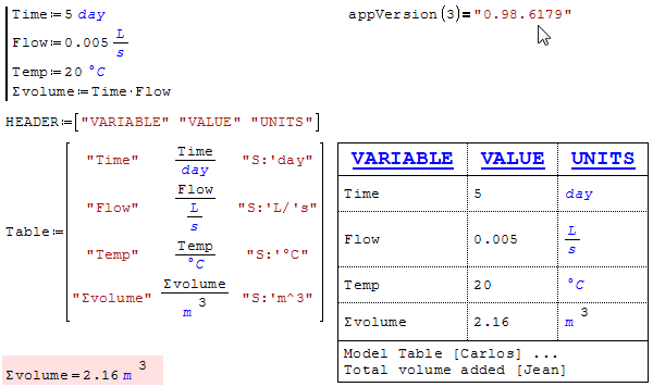

#9 Posted: 2018/6/26 18:32:55
26 likes in 155 posts.
CBG,

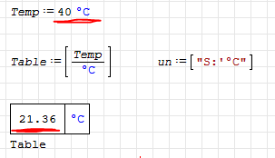

Using the unit summary to convert units back to original units doesn't work for temperature conversions. What you are doing with the units summary assumes the conversion is a factored multiplier. It works great for everything except temperature (or any other unit doesn't scale by a factored multiplier).
#10 Posted: 2018/6/26 21:28:04
Just define those units.
#11 Posted: 2018/6/26 21:49:54
Jean Giraud,
Maybe try something other than 20 deg?...
Version: 0.99(build: 6671)
#12 Posted: 2018/6/26 23:59:58
You are quite right and there are two things here
1. As it looks, the °C can't be made user.
The unit system is grounded on 'K', bloody pest to me.
2. The other thing is the Shadow in context, a real bug.
It worked fine from Carlos original [by what coincidence ?]
Not changing the context, context reproduces. Changing context
and the all thing °C gets freaked. I observed that many times
in Smath. In fact, very problematic.
Thanks for this wise observation.
Table Region Carlos.sm (10.6 KiB) downloaded 1170 time(s).
