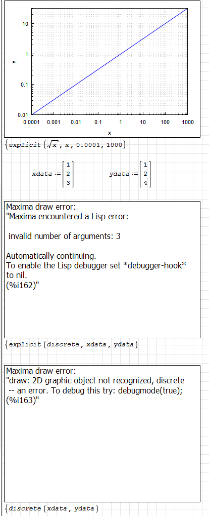

Hello all,
I need to do log-log and semilog plots of data in vectors.
I searched around and it seems Maxima would be the most flexible way to do it.
Can someone show me the correct syntax?
(I feel like a dummy ... )
TIA

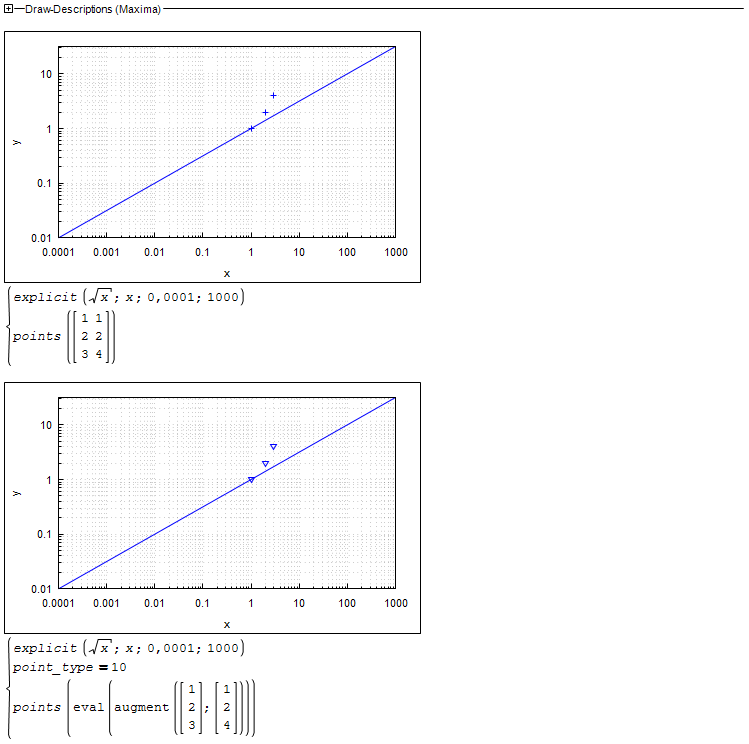

The command "discrete" isn't a valid draw command. Maxima has two ways of plotting, one using plot2d() and plot3d() and one using draw(). The Draw regions from the Maxima plugin as well as the functions Draw2D() and Draw3D() use the draw package, which is essentially an interface to gnuplot.
There is a lot of examples in the Samples>Maxima topic of the forum
You want to use the command points(matrix), where matrix is a two-column matrix of x and y data.
In my pdf Handbuch you find a lot of example plots. In recent version it seems that the draw regions aren't as robust as the DrawD/3D() commands.
In the attachment you find the smath sheet generating the handbuch plots.
Draw2D3D.sm (481.77 KiB) downloaded 635 time(s).
Draw2D3D.pdf (3.95 MiB) downloaded 459 time(s).
points1.sm (148.74 KiB) downloaded 649 time(s).
