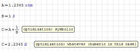

Hello Fred,
it is a bug; as workaround you can transit through a 3rd variable with symbolic optimization on his definition, then it is possible to evaluate numerically this variable in a separate region (see the cloud example)
![2016-08-06 15_21_29-SMath Studio Desktop - [OhmSiemens.sm_].png](/zh-Hans-CN/files/Download/A5YsGv/2016-08-06-15_21_29-SMath-Studio-Desktop---[OhmSiemens.sm_].png)
