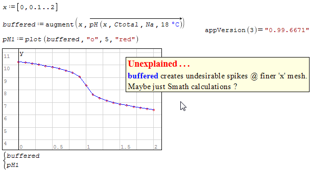

... refreshed, optimized calculation timing
Added the buffered plot to be splined for + values.
Inst_pH Solution.sm (44.9 KiB) downloaded 660 time(s)....refreshed/augmented

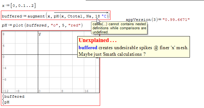

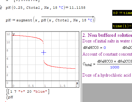

For me, the first plot is working
but the second is not - cases() is complaining.

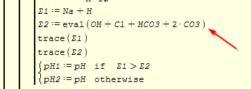

I could see that sigma2 went nuts (do not know why) and put eval() in front of it
I do not have the explanation of this - might be a bug.

1. Can't understand the error cases(,) [6671]

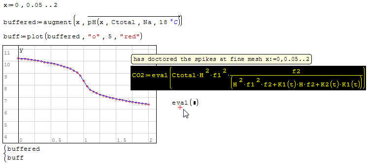

2. Make unit K was first problem , done well.
3. Doctoring for the spikes works and accelerates calculation timing.
Inst_pH Solution Copy.sm (46.65 KiB) downloaded 700 time(s).
