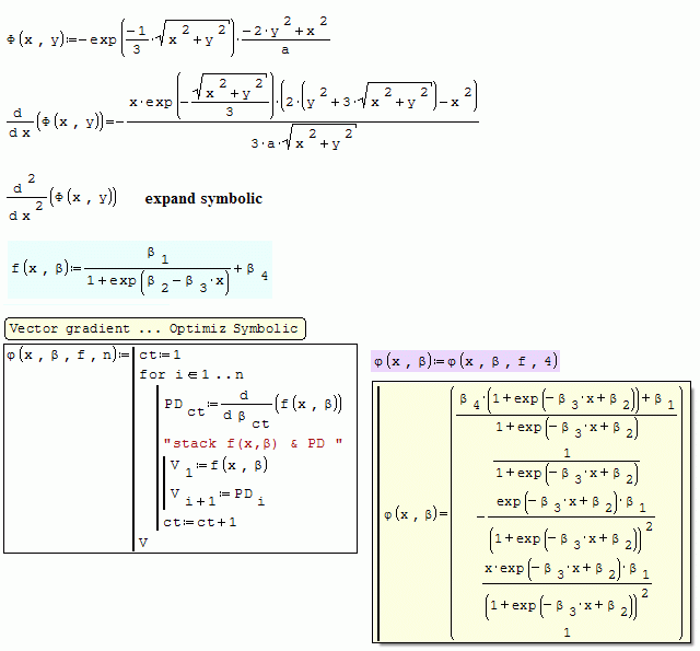

The way you write "diff(f,x)=0" ... I read 1rst derivative of 'f' wrt 'x'
then equate to 0 for roots. Simple: assign diff(f,x) to a new function,
for instance ff(x):=diff(f,x) ... equate ff(x)=0 for roots.
For the derivative of a vector, if the vector is not smooth you get derivative
+ an immense amount of noise. If the vector is smooth from a function, then get the drivative from the function, then evaluate at points. It could be Maple spline the
vector but that is as bad as good as you know nothing under the hood.
Cheers, Jean
Hi Jean. Yes, you're rigth. What I must to wrote was diff(f,x) identically equals zero, i.e. f'(x)=0 for all x in Domain(f). This is the good definition for independence criteria, and, as you say, diff(f,x)=0 is for search critical points.
