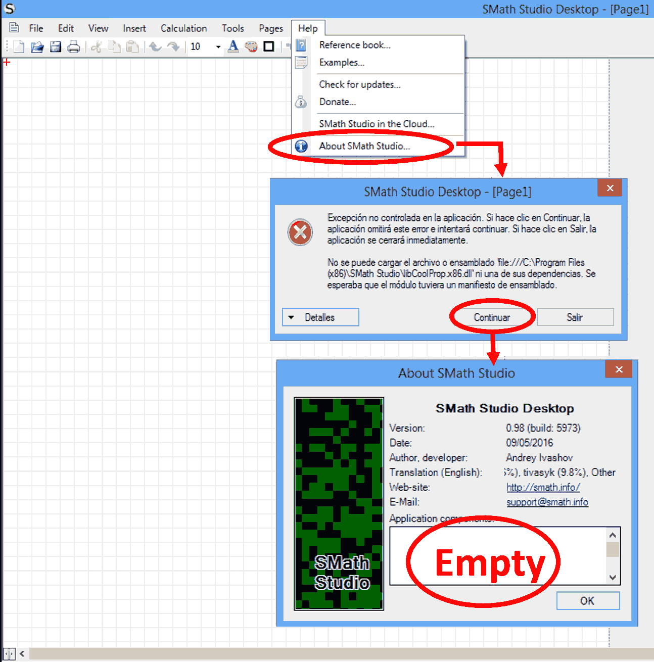

Carlos,
From you screenshot I see libCoolProp.x86.dll is located within SMath Studio directory. This tells me about some manual operations performed within SMath Studio installation directory.
Please uninstall SMath Studio, manually delete SMath Studio folder in C:\Program Files (x86) and install SMath Studio again.
Please also do not change anything manually in SMath Studio installation directory.
WroteSmath Studio gives this error when trying to know the version

Dear Andrey
You were right , the problem has already been solved.
Thank you so much
Carlos
Thank you so much
Carlos

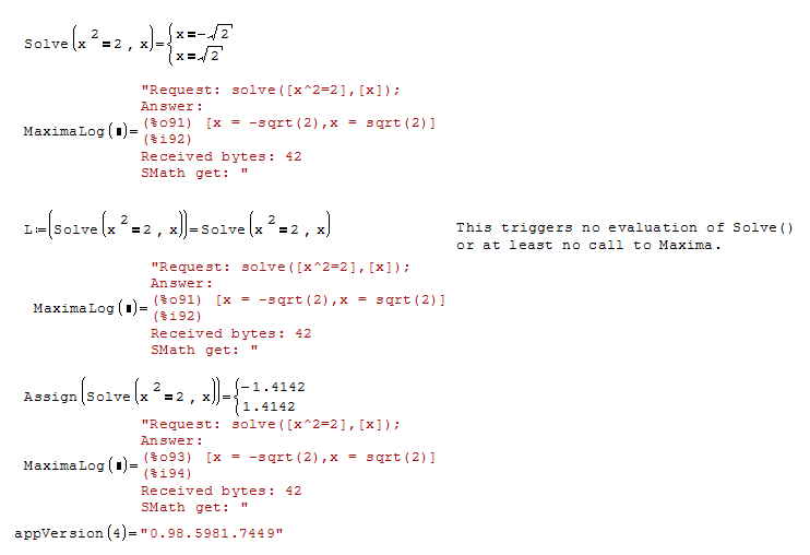

There is a new problem with Solve() from the Maxima plugin. If the function is part of an assignment, then it seems to not be called at all (no increment in the Maxima expression counter in the log).
If it is just evaluated, then it executes correctly.
Also, inside Assign() it works as expected.

Hello, Martin.
This is due to http://smath.info/bts/Issues/IssueDetail.aspx?id=2318 (details available there).
So, in case of assignment before execution SMath Studio checks if all required variables are defined. And functions at right of definition sign will be called only if this statement is true. Otherwise, all the calls will be postponed till the left side of the definition will be used somewhere (reason is obvious, see the screenshots in SS-2318 ticket).
But, there is a possibility to fix this behavior for specific functions in the plug-in: isUndefinedArgumentSupported agr should be set for ArgumentInfo in the plug-in.
Let me know if you still have questions.
Regards.
Regards.
Martin Kraska 2016/5/18 12:33:00
Andrey, thanks for the information.
Glad to hear that there is a clear reason for the behaviour and that there should be a straightforward fix. This sounds like a good initial project once I am up and running with reworking the maxima plugin.
