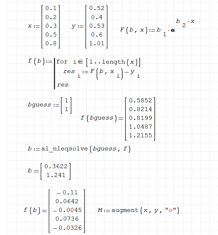

SMath Forum SMath Studio Samples Nonlinear curve fitting - example 1 Pages (2 items) Nonlinear curve fitting - example - using al_nleqsolve - Messages Go to last post #1 Posted: 2021/4/20 03:56:16 Radovan Omorjan 325 likes and 1 dislikes in 2,052 posts. Group: Moderator A simple example of curve fitting with al_nleqsolve().I hope someone will find it useful.Regards,Radovan nonlinfit.sm (8.74 KiB) downloaded 1248 time(s). When Sisyphus climbed to the top of a hill, they said: "Wrong boulder!" 5 users liked this postFridel Selitsky 2021/4/20 04:31:00, sergio 2021/4/20 05:13:00, NDTM Amarasekera 2021/4/20 05:45:00, Alvaro 2021/4/20 06:01:00, Davide Carpi 2021/4/20 07:14:00 #2 Posted: 2021/4/20 11:41:55 Jean Giraud 983 likes in 6,866 posts. Group: User Genfit [Algo Minimize(al_nleqsolve Alco, Thurber)].sm (85.48 KiB) downloaded 1111 time(s).I just posted this morning, but don't see ? 1 Pages (2 items) New Posts No New Posts
