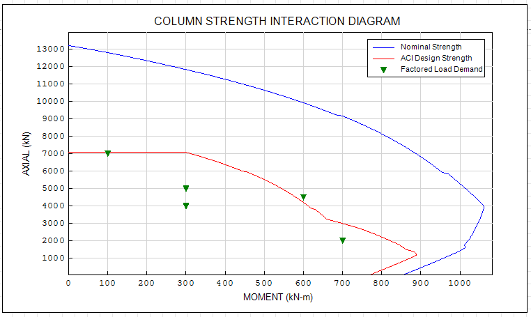

I've attached a file to generate the Compression and Bending Interaction diagram for rectangular sections, using ACI 318-11.
Any SI and US customary units work, but the results are in kN-m, which can be switched manually if you know where to look.
The rebar area and location column vectors can be made larger or smaller with no effect to the algorithm, So any number of steel layers can be used.
Future work: Expanding on this to include Biaxial Bending using the Reciprocal Load method. I had done this previously with MathCAD, and am currently working on a version for smath. I am having trouble getting it to be done without human input at certain points, but will keep working on it.
Please upload any improvements done to this file and post if any mistakes are found or if you have any suggestions.
Updated: Automatic scaling of the plot has been implemented. Also previously the section was treated as compression controlled, now the transition from compression controlled to tension controlled is taken into account.

I was thinking about what you said before about checking various columns in one sheet. One way I was playing with is to have one sheet for one section size, but used in multiple column locations so there would be different loads to check, and plotting those points to see if they are in the envelope or not. But with the X-Y plot I'm using, I haven't figured out a way to differentiate those points with one another (with labels or in the legend). (see attached image).

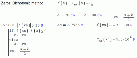

when I use the solve() function, an error occurs.
Is there a way to fix it?
how can find n value ?

Solvers are unstables, except maybe for al_nleqsolve. But here, and similar cases, you can implement always your own solver:
#14 Posted: 2019/10/21 09:24:53
when Iuse the solve() function, an error occurs.Is there a way to fix it?
... more solvers in there.
Solve Dichotomy.sm (19.94 KiB) downloaded 1544 time(s).
Solve roots Newton-Raphson.sm (51.33 KiB) downloaded 1586 time(s).
Solve roots_solve RootSecant (1).sm (104.62 KiB) downloaded 1610 time(s).

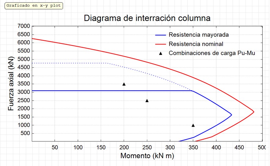

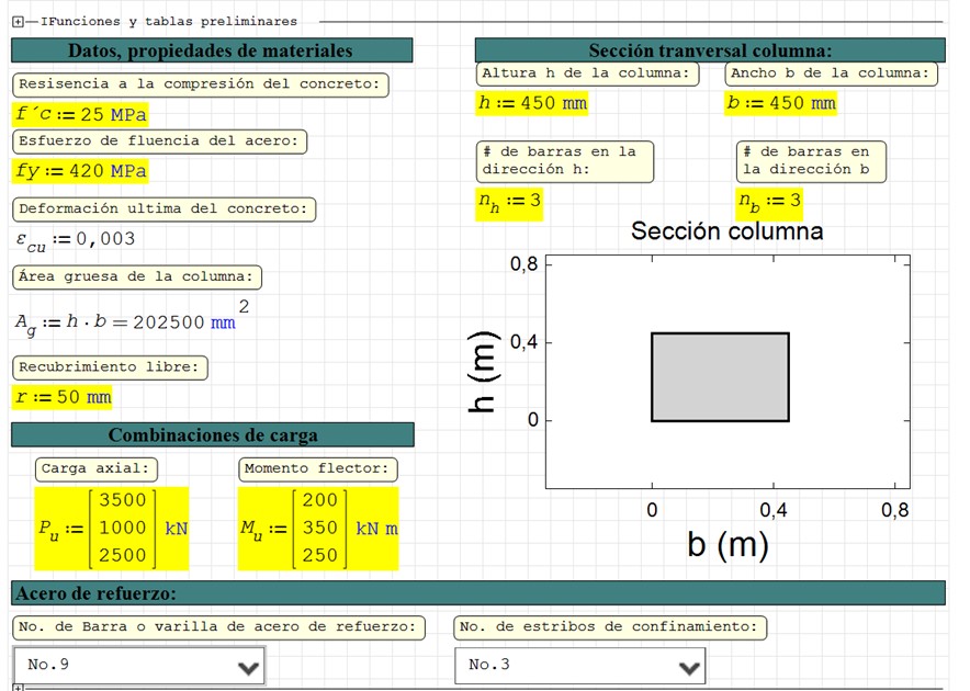

I had made my own code, but I was missing graphing, I took as a guide the code previously published here and additionally I added the graph the cross section of the column and the load combinations P-M, it would be missing to add the steel bars to that section to have a better graphical interface.
I will work to complement the code with bresler's reciprocal load method.
Diagrama de interaccion.sm (848.38 KiB) downloaded 1758 time(s).
